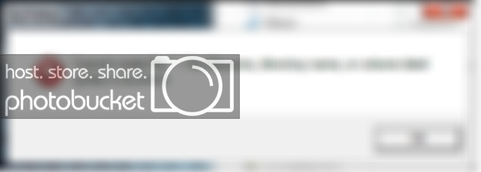

Reefboi16 Posted December 3, 2015 Author Posted December 3, 2015 Hey Spawk a little help I have followed your tutorial but got stuck with this error. I made sure to check none of the files within my folder are "read-only" Only one I could not take the attribute was the main folder. Even in command prompt it would not allow me to remove it. Pretty confused as I thought joy to key did not use registry entries

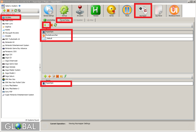

Spawk Posted December 3, 2015 Posted December 3, 2015 OK does your RL look like this: If you edit the Hyperspin profile in the bottom pane, it should have exactly the same controls as you set up earlier in the JTK HYPERSPIN Profile. The RocketLauncher profile is only used for navigation while in "HyperPause". I have not set this up yet so mine is blank ATM. If you want to set up an exit button for NES, you would select NES on the left pane (instead of global) and then edit the profile in the bottom pane. Let me know if this screen is setup correctly... Also there is no pic for it in the tutorial, but make sure this is done: 1.) Open RocketLauncherUI and choose Global in the left pane -> General Settings tab -> Third Party tab 2.) In KeyMapper area, define the path to JoyToKey executable in the JoyToKey Path box

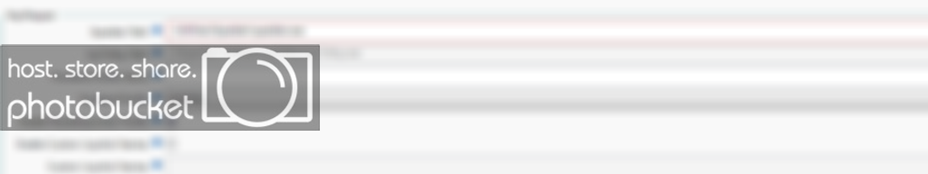

Reefboi16 Posted December 3, 2015 Author Posted December 3, 2015 Yes it looks just like that. Double checked and both are configured the same. on that ThirdParty tab. This is what I have making sure its right.

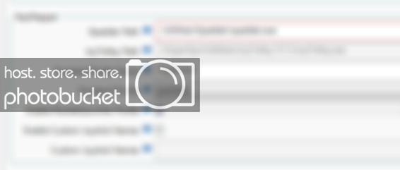

Reefboi16 Posted December 3, 2015 Author Posted December 3, 2015 Here is a screengrab of the other one you just showed me.
