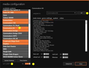

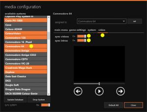

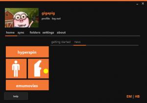

gigapig Posted December 18, 2015 Posted December 18, 2015 On 12/18/2015 at 9:18 PM, Bruiserh89 said: Sorry my newbie terminology might have made it confusing. I mean the preview movies in the hyperspin screen. The ones off to the side of the left of the wheel that go in the arcade cabinet of the hyperspin dashboard. Its says get them from emumovies but I dont really know how or what to get from there. Seems someone needs a guide for everything. So randomise the app is the easy way to get them? I would like them to come up for the specific game when I have that game highlighted on the wheel as a preview. Thanks for the patience lads. All new to me but I'm getting there No forget the randomizer that won't help you and is only for the movie that plays before HyperSpin starts. You need "HyperSync Cloud" which should be in your HyperSpin folder. Run "HyperSync Loader.exe" and log into your Emumovies account. Once logged in click the Arcade machine icon. Choose a system from the list to set up, then click to sync the system and set. Next choose "Videos" and switch the buttons. Once set up click close. Back at the main menu click the "Sync" button. From the "Systems" section choose either "All Systems" or choose a system from the list. From the "Media" section choose "Videos" and then the "Begin Sync" button. All being well the download process will start. Don't forget you will need a theme or default theme for the videos to show up.
Bruiserh89 Posted December 18, 2015 Author Posted December 18, 2015 On 12/18/2015 at 9:45 PM, gigapig said: No forget the randomizer that won't help you and is only for the movie that plays before HyperSpin starts. You need "HyperSync Cloud" which should be in your HyperSpin folder. Run "HyperSync Loader.exe" and log into your Emumovies account. Once logged in click the Arcade machine icon. Image 2.jpg Choose a system from the list to set up, then click to sync the system and set. Image 3.jpg Next choose "Videos" and switch the buttons. Image 4.jpg Once set up click close. Back at the main menu click the "Sync" button. From the "Systems" section choose either "All Systems" or choose a system from the list. From the "Media" section choose "Videos" and then the "Begin Sync" button. All being well the download process will start. Don't forget you will need a theme or default theme for the videos to show up. Brilliant. Thanks Crispy! I'll give that a go.
