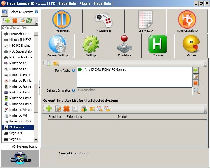

Do I need to add under 'add emulator' each game I want to add toward the bottom:
Also above adding lnk extension in global PCLauncher throws an error but games are all in green and don't work.  I have to leave extensions blank.  The roms point to a folder with the game shortcuts

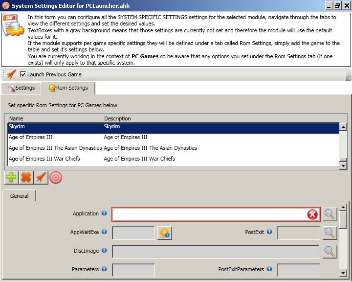

Here i have the steam ID, but i didn't want to use the steam ID.  What would I place/point to in the Application box and also what in the AppWaitexe box?  (a bit confused on these)

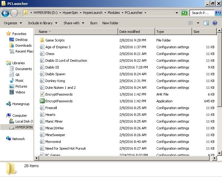

This is under PCLauncher Modules(or vice versa)
Module%20PCLauncher%20inis_zpssvl9m9vj.j
Does this look correct, inis for each game?

Just seeing if i'm on the right track:
Not sure what you mean about "add emulator" for each game. These are PC games so they don't use an actual emulator. PCLauncher is the correct "emulator" like you have set, but it's a virtual one.
You also have a Rom Path set, but these are PC games. Not roms. You normally just point each game to it's EXE or its SteamID in the PCLauncher module and leave the rom path blank (Although it looks like you're pointing to shortcuts instead of the exe?). Far as I know you shouldn't need a rom path unless you are running a non-pc game under the same wheel.
These aren't roms being run by an emulator so you shouldn't be adding extensions under Global>Emulators>PCLauncher.

The Application box is where you're supposed to put the path to your PC game (like I mentioned above). The path to the games EXE goes there, although I think you can also put the path to a LNK shortcut instead if you want... I'm curious why you're using shortcuts? However Steam games are a bit different, for those you leave the Application blank and put the Steam ID number in its box instead (matched to the SteamIDs.ini in the modules folder).
The AppWait.exe box is similar to setting your Fade Title. Sometimes RcoketLauncher needs help to know what window/exe to focus on for your game. Not all games need anything extra, but if they do you can try setting the Fade Title setting or the AppWaitExe setting. You can click the ? by each for instructions, but basically for AppWaitExe you would put the main exe that you want RocketLauncher to focus on. Fade Title uses the Window_Class instead of the exe. You only need to add something there if a game is giving you focus issues and you only use one of them. One might work better than the other depending on the game. (foe example MKX works better with AppWaitExe set to MK10.exe, JamesTown needs FadeTitle set instead and most games don't need anything in either)

Not sure what you have going on here either. I have a ton of Steam and non-Steam games and not a single one of them has it's own .ini file in the RocketLauncher>Modules>PCLauncher folder.
So I have no INIs to show you for Steam Games. The games individual module settings are in the PCLauncher.ini within that same folder. I have no idea what those INI's you have are from or why they are there.
EDIT: Unless they used to be done that way instead of setup in the SteamIDs.ini file?
Then again maybe you're just doing it all in a way I'm unaware of.
Is HyperLaunch 1.1.1.4 a really old version of HyperLaunch? I'm using RocketLauncher now, but I was using HyperLaunch before and it was really no different. I still basically setup PC games now just like I did then.
