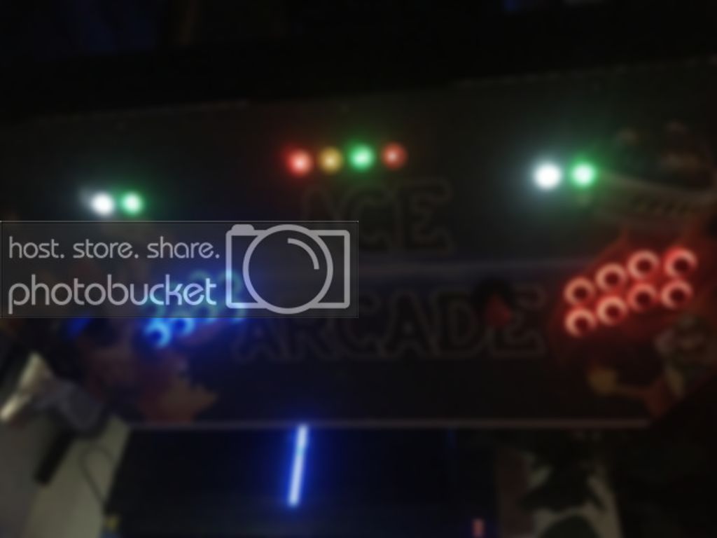

Reefboi16 Posted March 10, 2016 Posted March 10, 2016 Maybe I over killed it but its nice to have those buttons there I have a player one coin and start and a player two coin and start. I also have a exit button, pause, volume up, volume down, and power. LOL

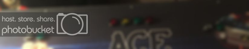

Reefboi16 Posted March 10, 2016 Posted March 10, 2016 Not the best image I can try to get a better one once home but here is my coin/start and admin buttons on my CP.
vaderag Posted March 10, 2016 Author Posted March 10, 2016 Are they little buttons? They looks small...
Reefboi16 Posted March 10, 2016 Posted March 10, 2016 Its a big control panel they are regular sized buttons about inch and a quarter. Its a pedestal cab so i made it wide it is being leaned on a lot by my brothers when they get up to sit down on the bar stools didn't want ti to tip over.
vaderag Posted March 10, 2016 Author Posted March 10, 2016 Cool. I kinda hoped they were small buttons as it gave me an idea for my exit button!! Ah well!
