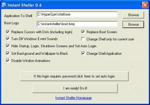

brock.sampson Posted August 17, 2009 Posted August 17, 2009 Having problems shelling hyperspin. I tried going directly to hyperspin and just got a blank screen. I made an autohotkey script as mentioned in this post. run, c:\hyperspin\hyperspin.exe I have instantsheller starting this shell.exe that I created and I still get a blank screen. If I open task manager hyperspin is running. Any ideas?
redtapemedia Posted August 19, 2009 Author Posted August 19, 2009 Having problems shelling hyperspin. I tried going directly to hyperspin and just got a blank screen. I made an autohotkey script as mentioned in this post.run, c:\hyperspin\hyperspin.exe I have instantsheller starting this shell.exe that I created and I still get a blank screen. If I open task manager hyperspin is running. Any ideas? You could try adding a delay before running HS. I found that (on my cab at least) if HS tried to launch too soon after booting up it caused issues. Try adding a delay in the script (either launch another program or add a wait in the script).
SophT Posted August 19, 2009 Posted August 19, 2009 yeah that could work something like: sleep, 2000 run, C:\hyperspin\hyperspin.exe Things I Break ----- System Requirements? How do I remove rom warnings? How do I shut-down my computer? How do I shell HyperSpin?
brock.sampson Posted August 20, 2009 Posted August 20, 2009 Still no dice. I tried 2000, 20000, and 60000. Also tried just hyperspin.exe. The script works fine when not run as the shell. This is my current script. Shell.exe is in the hyperspin folder. sleep, 60000 run, hyperspin.exe Also attached screenshot of what I'm setting for instantsheller.
