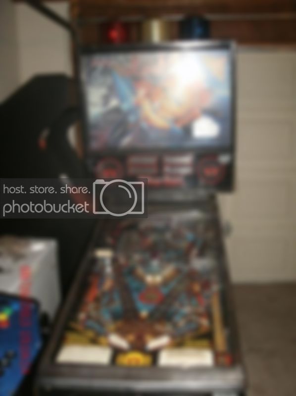

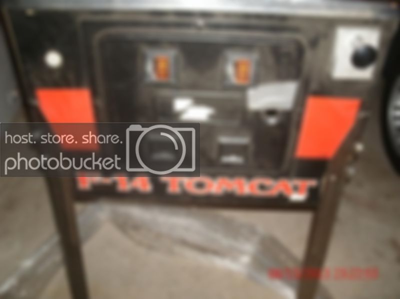

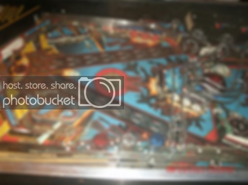

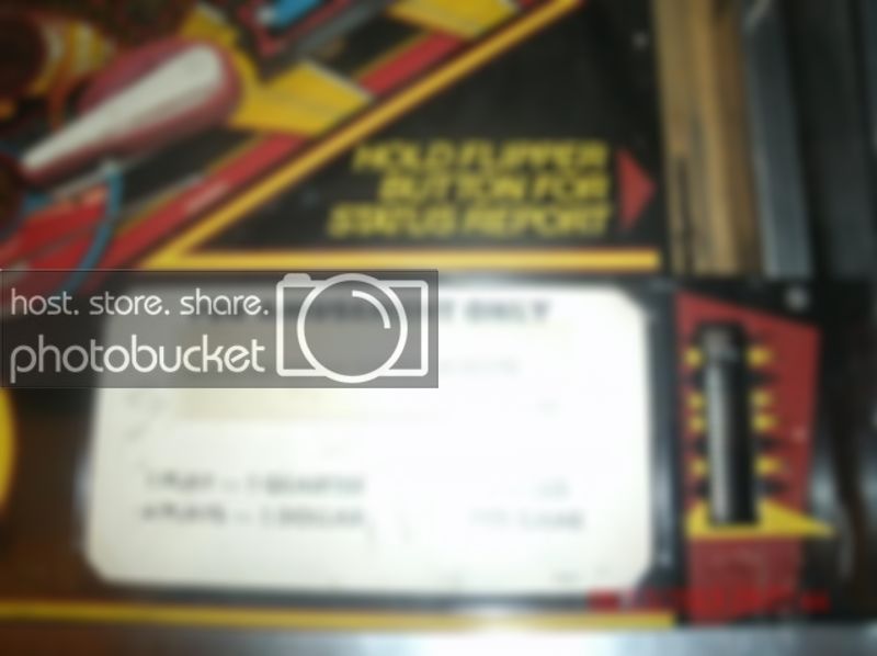

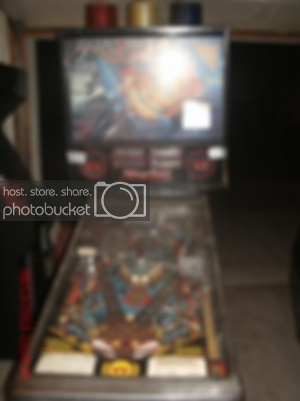

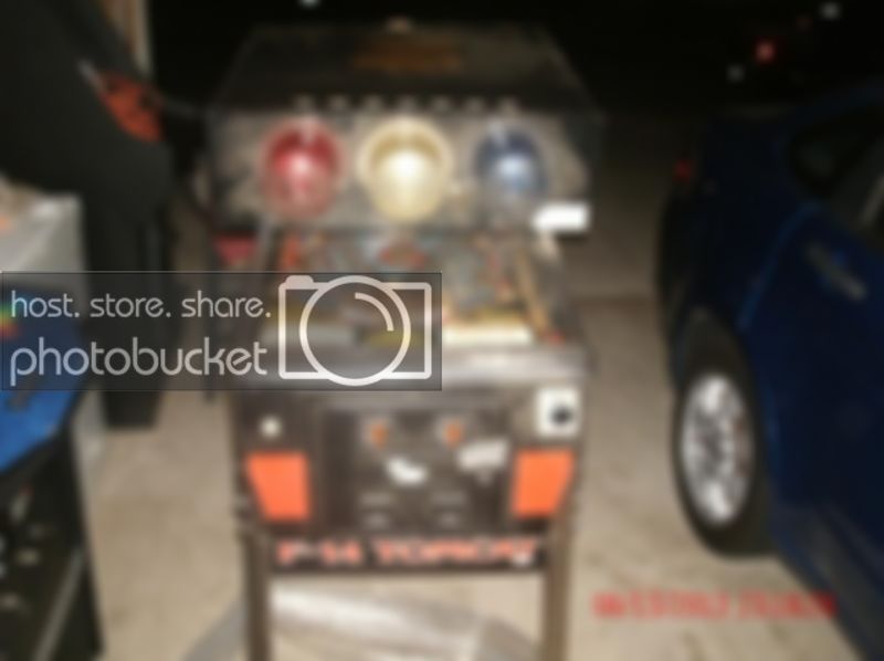

I've been wanting to get a pinball Machine for a long time. My Favorite one when I was a kid was F-14 Tomcat. I was like 7 years old when it came out and had the best light show I had ever seen. So when the time came and I could get my hands on one I picked up F-14 Tomcat. I've got some pictures of it and I will continue to post my progress on restoring it back to a clean working machine.

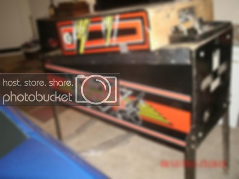

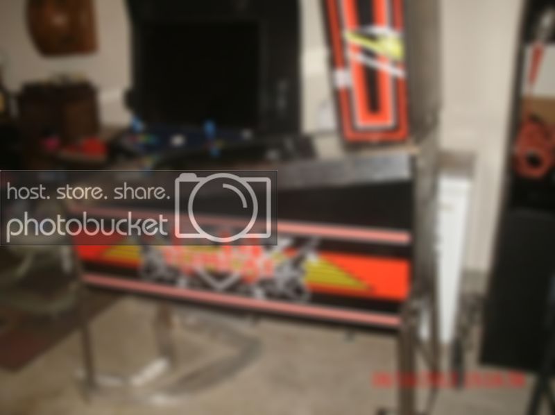

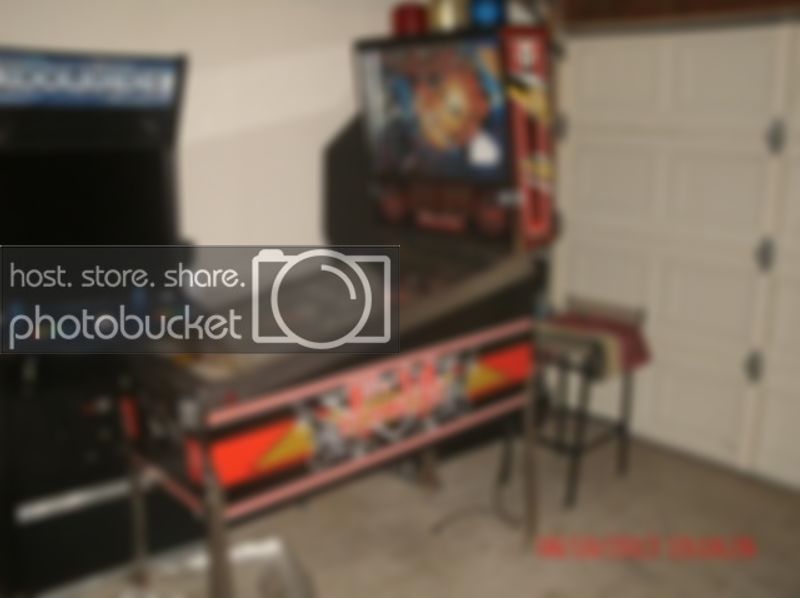

It looks like it was dropped at one point on it's side minor damage but I can fix it with some clamps and wood glue. The side art is in very good condition.

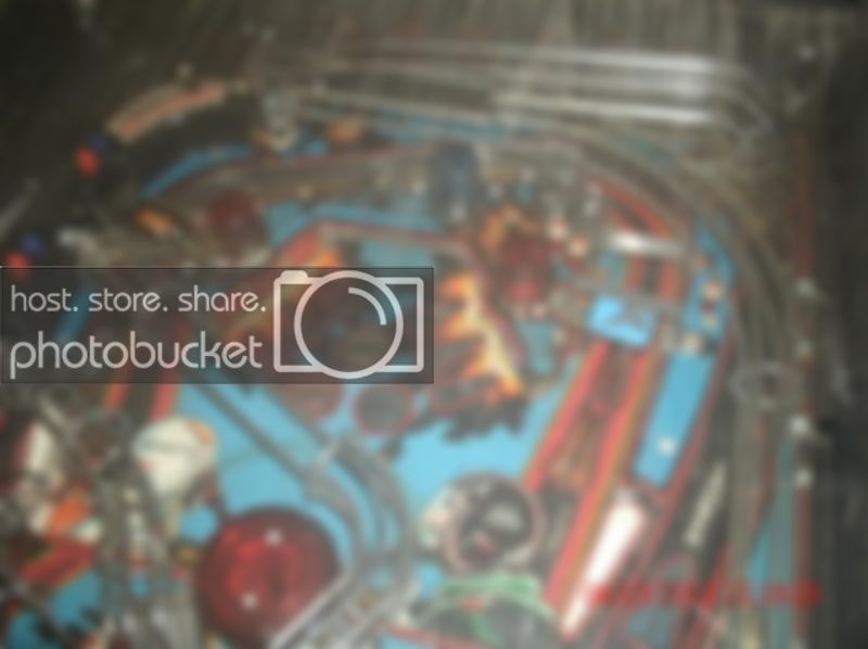

Needs a lot of cleaning and new locks.
