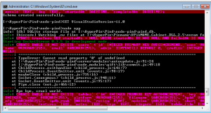

freezy Posted September 3, 2013 Author Posted September 3, 2013 /** * Path to installation folder. No trailing slash! * @important */ path: 'I:\HyperPin\Pinmame\VPinMAME_Cabinet_DLL_2.5', Error: ENOENT, no such file or directory 'I:\HyperPin\Pind\node-pind\HyperPinPinmameVPinMAME_Cabinet_DLL_2.5' I can't see much up with my config? I would try I:/HyperPin/Pinmame, that's the path of your VPM, right? Also, try slashes instead of backslashes.

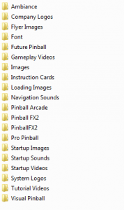

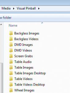

horseyhorsey Posted September 3, 2013 Posted September 3, 2013 Cool. That was it. I'm hoping this is the last error I shall receive? A couple of questions about the paths. Pinmame - Can we set the path to the full directory instead of Pind adding /nvram to the path? I don't keep my nvram in the pinmame directory, I don't really fancy having to rename my cloud shares for the use of this. VP & FP = The same kind of scenario as above. I keep all desktop/fullscreen seperate and no table folder resides in the program directorys. I won't really know how this works until I can try it out. Support for other frontend like PinballX , which has more or less the same directory structure. Weed Me! HS App: HLM-Check Beta: PinXCheckTunes: http://soundcloud.com/vade/mistys-mind-horse-mix HyperSpin Multiplayer - Take Your Cab online

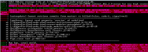

freezy Posted September 3, 2013 Author Posted September 3, 2013 Hmm looks like an error retrieving the last commit from your local repository. Did you use Git to checkout the files, or did you extract the zip file? I've committed a fix that should display the error message, if you could update and try again. About the paths: Sure, I suppose that would be possible. What other special paths do you have besides nvram and tables? Artwork? Roms? I'm aware of PinballX and also PinSelect, but I've never tried them and as far as I understood, they use the same structure than HyperPin. But checking those out is on my TODO list, so expect more support at some point.
horseyhorsey Posted September 3, 2013 Posted September 3, 2013 Yea, just using the tortoisegit to pull. Have to screenshot this because those errors do not appear in your log. Main media VP dir PinballX dir and contents. Weed Me! HS App: HLM-Check Beta: PinXCheckTunes: http://soundcloud.com/vade/mistys-mind-horse-mix HyperSpin Multiplayer - Take Your Cab online
freezy Posted September 3, 2013 Author Posted September 3, 2013 Well, did you install the git command line tool? That's necessary. And it must be in PATH. In my opinion that's the problem, but update and try again like this first, I hope the correct error message is displayed now.
horseyhorsey Posted September 3, 2013 Posted September 3, 2013 I went back and tried fresh without all the messing around with manualy installing the modules. Running cmd as admin, making sure python was working and using the SET VisualStudioVersion=11.0 before i did any node installs. I'm in now! & I have my directory set to PinballX, so we'll see how it goes. They seem to be matching good so far. Will have a good play around with it, Cheers for time & help! Weed Me! HS App: HLM-Check Beta: PinXCheckTunes: http://soundcloud.com/vade/mistys-mind-horse-mix HyperSpin Multiplayer - Take Your Cab online
