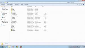

32assassin Posted October 29, 2013 Posted October 29, 2013 what exactlly is everything? can you post a screen shot of your zinc emulator folder to make sure you followed the module instructions ;---------------------------------------------------------------------------- ; Notes: ; Script relies on a zinc.cfg in the emu dir which contains all the parameters sent to the emu ; This is made for you by using Aldo's ZiNc Front-End v2.2. ; Zinc uses numbers, not romnames to choose what game to load. The module does the remapping for you so your database should consist of proper short rom names, not numbers. ;---------------------------------------------------------------------------- after you do all that you need to create a folder with FAKE ROMS, this fake roms will consist of emty folders zipped and numbered (1-81). When hyperlaunchHQ audits your roms it will see the fake roms but load the proper short named roms.

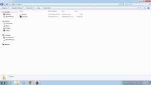

32assassin Posted October 29, 2013 Posted October 29, 2013 you don't need to keep the folders wind3d or winogl in your zinc emulator folder. when you download the d3d-ogl12.zip file; you found this files renderer.cfg wind3d/renderer.znc winogl/renderer.znc you have to replace the default video renderer that comes with the zinc emulator. depending on your video card you have to choose between the d3d or ogl options. did you move this files into your zinc emulator (renderer.cfg and renderer.znc) replace the default ones.? the roms have a number in front of the rom names The emulator loads by the number not the rom name. from your rom directory picture, hyperluanch will not find your roms. ( you should also be able to play the game by highlighting it and pressing the play button) THE XML only has the numbers, for what ever reason some people rename their roms from the actual name to the number system so that they will work in hyperspin., don't do that!!!! create a fake roms folder in your rom directory. add some empty folders names should be number 1-71 after that make sure to zip them. fake folder created in my rom directory fake folder rom path added to hyperlaunch empty folders zipped and named using number system when ever you audit your zinc through hyperlaunch. Hyperlaunch will see the fake files but load the correctly named roms.

AYOOOB Posted October 29, 2013 Author Posted October 29, 2013 yes i moved renderer.cfg , and renderer.znc
AYOOOB Posted October 29, 2013 Author Posted October 29, 2013 thanks man really appreciate it thanks for the help again its working now thanks again
