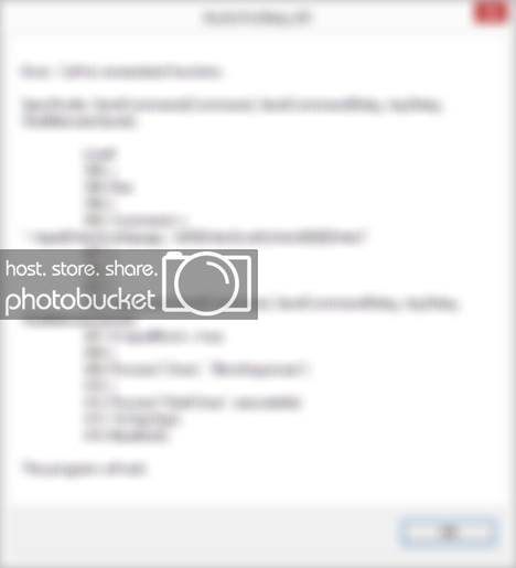

craiganderson Posted November 26, 2014 Posted November 26, 2014 i keep getting this error with both methods maybe im doing something wrong? http://craigandersonthemes.weebly.com/
rfancella Posted November 26, 2014 Posted November 26, 2014 i keep getting this errorwith both methods maybe im doing something wrong? No, it's not on your end. That function is in beta. My bad. Let me revise the module. Thanks, Ron Code Monkey and all around Command Line geek!If you like what someone has said or done for you, be sure and 'Thank' them. And if they changed your life, send them a Beer!
craiganderson Posted November 26, 2014 Posted November 26, 2014 cool thanks for your work craig http://craigandersonthemes.weebly.com/
rfancella Posted November 26, 2014 Posted November 26, 2014 coolthanks for your work craig Craig, Use the isd above and this module: BeebEm.ahk - http://pastebin.com/kmjczayx Also, for this module to be completely automated, all the .ssd files need to have a customer rom setting for the command. Example: I have an ssd rom called "3D Convoy (1984)(Doctor Soft)(3DCONVY start).ssd" So, go into the Module settings/Rom Settings and enter 3dconvy in the startCommand box. Let me know. Thanks, Ron Code Monkey and all around Command Line geek!If you like what someone has said or done for you, be sure and 'Thank' them. And if they changed your life, send them a Beer!
