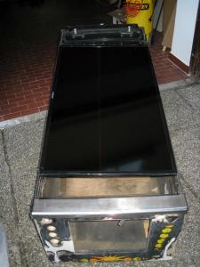

piggei Posted December 1, 2013 Posted December 1, 2013 I use a Samsung UE40EH5000 (European version) and fits perfectly. Below you can see a picture with the TV over a standard cab. The bezel is thin, as well as television. This model is cheap because it's an old serie without network connection or 3D, but still for sale.
wowter Posted December 3, 2013 Posted December 3, 2013 I use a Samsung UE40EH5000 (European version) and fits perfectly. Below you can see a picture with the TV over a standard cab.[ATTACH=CONFIG]35708[/ATTACH] The bezel is thin, as well as television. This model is cheap because it's an old serie without network connection or 3D, but still for sale. It does not look like it will fit inside the cabinet. You put it on top of the wood? like an oldschool build? I was looking at the Panasonic TX-L39E6EK, it is relatively cheap, and supposed to be only 519 mm high, which should JUST fit inside a standard cabinet, without the need for decasing. It does look like it has a protrusion at the bottom (for the logo) Anyone used this TV?
piggei Posted December 9, 2013 Posted December 9, 2013 It does not look like it will fit inside the cabinet. You put it on top of the wood? like an oldschool build? Yes... It's the best way if you use an original standard cab. But if you make your own cab from scratch you can route 1cm deep rail for side...
