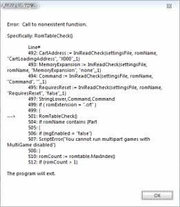

excuse me i am italian, i have problem whit hyperlaunch hq and winvice.
this is problem:
Can i have help please or the last winvice.ahk mod?
this is problem:
[ATTACH=CONFIG]46369[/ATTACH]
Hi!
To update all your HyperLaunch files and modules, take a look at this post:
http://www.hyperspin-fe.com/forum/showthread.php?31472-Complete-Guide-for-Commodore-Amiga-in-HS-and-RL-Using-WinUAE-Only&p=304130&viewfull=1#post304130
It has a link to the GIT page for easy updates or instructions to do a one time update.

  egitto said:
WINVICE.ahk
MEmu = WinVICE
MEmuV = v2.4
MURL = http://vice-emu.sourceforge.net/
MAuthor = djvj,wahoobrian,brolly
MVersion = 2.0.2
MCRC = BA37ED39
iCRC = DAA4D1EA
MID = 635038268966170754
MSystem = "Commodore 64","Commodore 16 & Plus4","Commodore VIC-20"
emulator winvice *** VICE Version 2.4 ***
Almost 100%. :D
Change your logging level in HLHQ to Troubleshoting and post the complete log including the end of code tag. It doesn't need to be in a quote tag, but code. The log should have both code tags in it already.
Thanks,
Ron

23:09:22:182 | HL |   DEBUG1  | +0     | BuildScript - Module starts on line: 2

						varBlock0 = 0
						varBlock1 = 0
						varBlock2 = 0
						varBlock3 = 0
						varBlock5 = 0
						If (MemoryExpansion = "3k") {
							varBlock0 = 1
						} Else If (MemoryExpansion = "8k") {
							varBlock1 = 1
						} Else If (MemoryExpansion = "16k") {
							varBlock1 = 1
							varBlock2 = 1
						} Else If (MemoryExpansion = "24k") {
							varBlock1 = 1
							varBlock2 = 1
							varBlock3 = 1
						} Else If (MemoryExpansion = "all") {
							varBlock0 = 1
							varBlock1 = 1
							varBlock2 = 1
							varBlock3 = 1
							varBlock5 = 1
						} Else If (MemoryExpansion = "3,5") {
							varBlock3 = 1
							varBlock5 = 1
						} Else If (MemoryExpansion = "5") {
							varBlock5 = 1
						} Else If (MemoryExpansion = "1,5") {
							varBlock1 = 1
							varBlock5 = 1
						} Else If (MemoryExpansion = "1,2,5") {
							varBlock1 = 1
							varBlock2 = 1
							varBlock5 = 1
						IniWrite, %varBlock0%, %viceINI%, VIC20, RAMBlock0
						IniWrite, %varBlock1%, %viceINI%, VIC20, RAMBlock1
						IniWrite, %varBlock2%, %viceINI%, VIC20, RAMBlock2
						IniWrite, %varBlock3%, %viceINI%, VIC20, RAMBlock3
						IniWrite, %varBlock5%, %viceINI%, VIC20, RAMBlock5
						Run(executable . " " . params . " """ . romPath . "\" . romName . romExtension . """" , emuPath )
					if (RequiresReset = "true")
						WinWaitActive("ahk_class VICE")
						Sleep, 1000 ; increase if command is not appearing in the emu window or some just some letters
						Send !r
					if %Command% {
						Sleep, %SendCommandDelay% ; increase if command is not appearing in the emu window or some just some letters
						SetKeyDelay, 50
						Loop, parse, Command
							Send, {%A_LoopField% down}{%A_LoopField% up}
						Send, {ENTER down}{ENTER up}
				WinWait("ahk_class VICE")
				FadeInExit()
				7zCleanUp()
				FadeOutExit()
				ExitModule()
				JoySwap:
					Send !j
				Return
				Warp:
					Send !w
				Return
				StartTape:
					Send !{F7}
				Return
				StopTape:
					Send !{F8}
				Return
				RunTape:
					SetKeyDelay, 50
				Return
				HaltEmu:
					If (Fullscreen = "true")
						Send !{Enter}
				Return
				MultiGame:
					Log("MultiGame Label was run!")
					If romExtension in .d64,.d71,.d80,.d81,.d82,.g64,.g41,.x64,.prg
					{	Send !8 ; swaps a Disk
						wvTitle:="Attach disk image ahk_class #32770"
					} Else If romExtension in .t64,.tap
					{	Send !t ; swaps a Tape
						wvTitle:="Attach tape image ahk_class #32770"
					} Else
						ScriptError(romExtension . " is an invalid multi-game extension")
					WinWait(wvTitle)
					WinWaitActive(wvTitle)
					If ( SelectGameMode = 1 ) {
						Loop {
							ControlGetText, edit1Text, Edit1, %wvTitle%
							If ( edit1Text = selectedRom )
								Break
							Sleep, 100
							ControlSetText, Edit1, %selectedRom%, %wvTitle%
						ControlSend, Button1, {Enter}, ahk_class #32770 ; Select Open
					} Else If ( SelectGameMode = 2 ) {
						Clipboard := selectedRom
						Send, ^v{Enter}
					} Else
						ScriptError("You did not choose a valid SelectGameMode.`nOpen the module and set the mode at the top.")
					Log("Module - WinWaitActive`, ahk_class VICE`, `, 5")
					WinWaitActive("ahk_class VICE",,5)
					WinActivate, ahk_class VICE
				Return
				RestoreEmu:
						Send !{Enter}
				Return
				CloseProcess:
					FadeOutStart()
					WinClose("ahk_class VICE")
				Return
23:09:22:201 | HL |     INFO  | +16    | BuildScript - Loaded Statistics.ahk script
23:09:22:204 | HL |     INFO  | +0     | BuildScript - Loaded User Functions.ahk script
23:09:22:210 | HL |     INFO  | +0     | BuildScript - Finished injecting functions into module
23:09:22:215 | HL |     INFO  | +16    | Main - Module is built
23:09:22:223 | HL |     INFO  | +0     | CheckFile - Checking if F:\HyperSpin\HyperLaunch\AutoHotkey.dll exists
23:09:22:267 | HL |   DEBUG1  | +46    | CheckFile - Attributes:
				File Size:			785408 bytes
				Created:			11/3/2014 - 7:07:15
				Modified:			11/3/2014 - 7:07:16
23:09:22:517 | HL |     INFO  | +250   | Main - Running module
23:09:22:525 | HL |     INFO  | +16    | Main - Starting timer to watch if Front End gets displaced and restore it if it does.
23:09:24:265 | MD |     INFO  | +N/A   | Module initialized
23:09:24:641 | MD |     INFO  | +375   | StartModule - Started
23:09:24:648 | MD |     INFO  | +15    | StartModule - MEmu: WinVICE
				MEmuV: v2.4
				MURL: http://vice-emu.sourceforge.net/
				MAuthor: djvj,wahoobrian,brolly
				MVersion: 2.0.2
				MCRC: BA37ED39
				iCRC: DAA4D1EA
				MID:
				MSystem: "Commodore 64","Commodore 16 & Plus4","Commodore VIC-20"
23:09:24:653 | MD |     INFO  | +0     | StartModule - You have a supported System Name for this module: "Commodore 64"
23:09:24:659 | MD |   DEBUG1  | +0     | StartModule - Leaving romName as is because Rom Mapping filled it with an Alternate_Rom_Name: BABYBLU3_00528_01
23:09:24:663 | MD |     INFO  | +16    | StartModule - Ended
23:09:24:677 | MD |     INFO  | +15    | StartGlobalUserFeatures - Starting
23:09:24:681 | MD |     INFO  | +0     | StartGlobalUserFeatures - Ending
23:09:24:685 | MD |     INFO  | +0     | Module Setting - [settings] - Fullscreen: true
23:09:24:695 | MD |     INFO  | +16    | Module Setting - [settings] - WarpKey: F9
23:09:24:702 | MD |     INFO  | +0     | Module Setting - [settings] - JoySwapKey: F10
23:09:24:707 | MD |     INFO  | +16    | Module Setting - [settings] - StartTapeKey: F7
23:09:24:714 | MD |     INFO  | +0     | Module Setting - [settings] - StopTapeKey: F8
23:09:24:722 | MD |     INFO  | +15    | Module Setting - [settings] - SelectGameMode: 1
23:09:24:726 | MD |     INFO  | +0     | Module Setting - [bABYBLU3_00528_01] - UsePaddles: false
23:09:24:729 | MD |     INFO  | +0     | Module Setting - [bABYBLU3_00528_01] - AutostartPrgMode: 2
23:09:24:732 | MD |     INFO  | +0     | Module Setting - [bABYBLU3_00528_01] - RequiresReset: false
23:09:24:735 | MD |     INFO  | +0     | 7z - Started, received F:\Game\Commodore 64\ROMs\BABYBLU3_00528_01.zip. If rom is an archive, it will extract to F:\HyperSpin\HyperLaunch\Module Extensions\Estrazione
23:09:24:737 | MD |   DEBUG1  | +0     | 7z - Using Standard method to extract this rom
23:09:24:741 | MD |   DEBUG1  | +16    | 7z - ".zip" found in .zip,.rar,.7z,.lzh,.gzip,.tar
23:09:24:749 | MD |     INFO  | +0     | CheckFile - Checking if F:\Game\Commodore 64\ROMs\BABYBLU3_00528_01.zip exists
23:09:24:776 | MD |   DEBUG1  | +31    | CheckFile - Attributes:
				File Size:			25413 bytes
				Created:			11/11/2014 - 9:56:48
				Modified:			7/10/2014 - 9:14:58
23:09:31:738 | MD |  WARNING  | +6958  | 7z - Archive name DOES NOT MATCH rom name; DLL found rom inside archive using "findByExtension": BABYBLU3.T64
23:09:32:100 | MD |   DEBUG1  | +359   | 7z - Invoked COM Object, ROM extracted size: 26468 bytes
23:09:32:278 | MD |   DEBUG1  | +187   | 7z - File does not already exist in 7z_Extract_Path, proceeding to extract it.
23:09:32:456 | MD |   DEBUG1  | +171   | 7z - File found in archive
23:09:32:597 | MD |     INFO  | +141   | 7z - Extracted path of rom will be 84 in length and within the 255 character limit.
23:09:32:955 | MD |     INFO  | +359   | 7z - The 7zExtractPath has 1010712 MB of free space which is enough to extract this game: 0 MB
23:09:33:134 | MD |   DEBUG1  | +187   | 7z - Starting 7z extraction of F:\Game\Commodore 64\ROMs\BABYBLU3_00528_01.zip  to F:\HyperSpin\HyperLaunch\Module Extensions\Estrazione\BABYBLU3_00528_01
23:09:37:417 | MD |   DEBUG1  | +4274  | 7z - Finished 7z extraction
23:09:37:420 | MD |   DEBUG1  | +0     | 7z - Found file in F:\HyperSpin\HyperLaunch\Module Extensions\Estrazione\BABYBLU3_00528_01\BABYBLU3.T64
23:09:37:440 | MD |     INFO  | +31    | 7z - Ended
23:09:37:482 | MD |     INFO  | +32    | CheckFile - Checking if F:\HyperSpin\Emulators\WinVICE\vice.ini exists
23:09:37:588 | MD |   DEBUG1  | +109   | CheckFile - Attributes:
				File Size:			7982 bytes
				Created:			11/2/2014 - 8:11:58
				Modified:			11/12/2014 - 11:37:36
23:09:37:604 | MD |     INFO  | +15    | Module Setting - [bABYBLU3] - VideoMode: PAL
23:09:37:634 | MD |     INFO  | +32    | Run - Running: F:\HyperSpin\Emulators\WinVICE\x64.exe +confirmexit -pal "F:\HyperSpin\HyperLaunch\Module Extensions\Estrazione\BABYBLU3_00528_01\BABYBLU3.T64"
23:09:40:142 | MD |   DEBUG1  | +2511  | Run - "x64.exe +confirmexit -pal "F:\HyperSpin\HyperLaunch\Module Extensions\Estrazione\BABYBLU3_00528_01\BABYBLU3.T64"" Process ID: 5624
23:09:40:330 | MD |   DEBUG1  | +187   | GetActiveWindowStatus - Title: HyperSpin | Class: ThunderRT6FormDC | State: 0 | X: 0 | Y: 0 | Width: 1366 | Height: 768 | Window HWND: 0x7b05d0 | Process ID: 5468 | Process Path: F:\HyperSpin\HyperSpin.exe
23:09:40:377 | MD |     INFO  | +47    | WinWait - Waiting for "ahk_class VICE"
23:09:42:698 | MD |   DEBUG1  | +2325  | GetActiveWindowStatus - Title: VICE: C64 emulator | Class: VICE | State: 0 | X: 231 | Y: 54 | Width: 909 | Height: 588 | Window HWND: 0x780906 | Process ID: 5624 | Process Path: F:\HyperSpin\Emulators\WinVICE\x64.exe
23:09:42:701 | MD |   DEBUG1  | +0     | GetActiveWindowStatus - Title: VICE: C64 emulator | Class: VICE | State: 0 | X: 231 | Y: 54 | Width: 909 | Height: 588 | Window HWND: 0x780906 | Process ID: 5624 | Process Path: F:\HyperSpin\Emulators\WinVICE\x64.exe
23:09:42:707 | MD |     INFO  | +0     | WinWaitActive - Waiting for "ahk_class VICE"
23:09:42:823 | MD |   DEBUG1  | +124   | GetActiveWindowStatus - Title: VICE: C64 emulator | Class: VICE | State: 0 | X: 231 | Y: 54 | Width: 778 | Height: 636 | Window HWND: 0x780906 | Process ID: 5624 | Process Path: F:\HyperSpin\Emulators\WinVICE\x64.exe
23:09:42:829 | MD |     INFO  | +0     | Process - WaitClose x64.exe
23:10:06:464 | MD |   DEBUG1  | +23635 | CloseProcess - Started, user requested to end launched application
23:10:06:467 | MD |     INFO  | +0     | WinClose - Closing: ahk_class VICE
23:10:09:375 | MD |   DEBUG1  | +2917  | CloseProcess - Ended
23:10:12:314 | MD |     INFO  | +2933  | 7zCleanUp - Started
23:10:14:082 | MD |   DEBUG1  | +1778  | 7zCleanUp - Deleted F:\HyperSpin\HyperLaunch\Module Extensions\Estrazione\BABYBLU3_00528_01
23:10:14:085 | MD |     INFO  | +0     | 7zCleanUp - Ended
23:10:14:087 | MD |     INFO  | +0     | StopGlobalUserFeatures - Starting
23:10:14:090 | MD |     INFO  | +0     | StopGlobalUserFeatures - Ending
23:10:14:093 | MD |     INFO  | +0     | ExitModule - Started
23:10:14:095 | MD |     INFO  | +0     | Starting Updating Statistics:
23:10:14:098 | MD |   DEBUG2  | +16    | Total Elapsed Time in Pause in seconds: 0
23:10:14:100 | MD |   DEBUG2  | +0     | gameSectionStartTime:530812184
23:10:14:103 | MD |   DEBUG2  | +0     | ElapsedTime:49
23:10:14:120 | MD |     INFO  | +15    | CreateRomTable - Started
23:10:14:123 | MD |   DEBUG1  | +0     | CreateRomTable - Checking for match: "BABYBLU3_00528_01" and "(Disc"
23:10:14:125 | MD |   DEBUG1  | +0     | CreateRomTable - Checking for match: "BABYBLU3_00528_01" and "(Disk"
23:10:14:128 | MD |   DEBUG1  | +16    | CreateRomTable - Checking for match: "BABYBLU3_00528_01" and "(Cart"
23:10:14:131 | MD |   DEBUG1  | +0     | CreateRomTable - Checking for match: "BABYBLU3_00528_01" and "(Tape"
23:10:14:133 | MD |   DEBUG1  | +0     | CreateRomTable - Checking for match: "BABYBLU3_00528_01" and "(Cassette"
23:10:14:136 | MD |   DEBUG1  | +0     | CreateRomTable - Checking for match: "BABYBLU3_00528_01" and "(Part"
23:10:14:139 | MD |   DEBUG1  | +0     | CreateRomTable - Checking for match: "BABYBLU3_00528_01" and "(Side"
23:10:14:144 | MD |     INFO  | +15    | CreateRomTable - Ended, 7 Loops to create table.
23:10:14:147 | MD |   DEBUG2  | +0     | Statistics cleared game name: BABYBLU3_00528_01
23:10:14:271 | MD |   DEBUG2  | +125   | Loaded game statistics from ini files:
				Number_of_Times_Played: 0
				Last_Time_Played: 0
				Average_Time_Played: 0
				Total_Time_Played: 0
				System_Total_Played_Time: 2168
				Total_Global_Played_Time: 5742
23:10:14:273 | MD |   DEBUG2  | +0     | Updated Statistics: Number_of_Times_Played: 1
				Last_Time_Played: gioved� novembre 13, 2014 11:09:24
				Average_Time_Played: 49
				Total_Time_Played: 49
				System_Total_Played_Time: 2217
				Total_Global_Played_Time: 5791
23:10:14:414 | MD |     INFO  | +141   | Game section statistics updated.
23:10:14:624 | MD |     INFO  | +202   | ExitModule - Ended
23:10:14:638 | MD |     INFO  | +16    | End of Module Logs
23:10:14:948 | HL |     INFO  | +52416 | Main - Module ended, exiting HyperLaunch normally
23:10:14:950 | HL |     INFO  | +0     | ExitScript - Started
23:10:14:972 | HL |   DEBUG1  | +31    | ExitScript - Checking what application is currently in focus.
23:10:14:977 | HL |   DEBUG1  | +0     | ExitScript - HyperSpin is currently active. Putting focus back on HyperSpin.exe
I hope it goes well, I changed Troubleshoting level and I put everything between code and / code.
Sorry again my ignorance in English and this wonderful program
16/11/2014
Buona sera volevo avvertire che, non so per quale motivo, ma adesso funziona; io non ho fatto nessuna modifica ma oggi funziona. L'unico problema è che se metto come video file.FLV e non immagini PNG, quando eseguo un gioco si sente l'adio del file.FLV sotto.
Good evening, I wanted to warn you that I do not know why, but now it works; I have not made any changes, but now it works. The only problem is that if I put as video file.FLV and not file.PNG images, when I play a game you can hear the adio of file.FLV background.

12:55:46:246 | HL |   DEBUG1  | +0     | MultiGame Init.ahk Version: 1.0.0
12:55:46:246 | HL |     INFO  | +0     | CheckFile - Checking if C:\Emulation\hyperlaunch-3\Lib\MultiPlayer.ahk exists
12:55:46:261 | HL |   DEBUG1  | +16    | CRC Check - CRC matches, this is an official unedited Library.
12:55:46:261 | HL |   DEBUG1  | +0     | CheckFile - Attributes:
				File Size:			55551 bytes
				Created:			12/30/2014 - 4:34:48 PM
				Modified:			12/30/2014 - 4:34:48 PM
12:55:46:261 | HL |   DEBUG1  | +0     | MultiPlayer.ahk Version: 1.0.0
12:55:46:261 | HL |     INFO  | +0     | CheckFile - Checking if C:\Emulation\hyperlaunch-3\Lib\Password.ahk exists
12:55:46:261 | HL |   DEBUG1  | +0     | CRC Check - CRC matches, this is an official unedited Library.
12:55:46:277 | HL |   DEBUG1  | +16    | CheckFile - Attributes:
				File Size:			10035 bytes
12:55:46:277 | HL |   DEBUG1  | +0     | Password.ahk Version: 1.0.0
12:55:46:277 | HL |     INFO  | +0     | CheckFile - Checking if C:\Emulation\hyperlaunch-3\Lib\Rom Mapping Launch Menu.ahk exists
12:55:46:293 | HL |   DEBUG1  | +15    | CRC Check - CRC matches, this is an official unedited Library.
12:55:46:293 | HL |   DEBUG1  | +0     | CheckFile - Attributes:
				File Size:			73560 bytes
				Created:			8/11/2014 - 9:10:32 PM
12:55:46:293 | HL |   DEBUG1  | +0     | Rom Mapping Launch Menu.ahk Version: 1.0.3
12:55:46:293 | HL |     INFO  | +0     | CheckFile - Checking if C:\Emulation\hyperlaunch-3\Lib\Shared.ahk exists
12:55:46:308 | HL |   DEBUG1  | +16    | CRC Check - CRC matches, this is an official unedited Library.
12:55:46:308 | HL |   DEBUG1  | +0     | CheckFile - Attributes:
				File Size:			139727 bytes
12:55:46:308 | HL |   DEBUG1  | +0     | Shared.ahk Version: 1.1.9
12:55:46:308 | HL |     INFO  | +0     | CheckFile - Checking if C:\Emulation\hyperlaunch-3\Lib\Statistics.ahk exists
12:55:46:308 | HL |   DEBUG1  | +0     | CRC Check - CRC matches, this is an official unedited Library.
12:55:46:324 | HL |   DEBUG1  | +15    | CheckFile - Attributes:
				File Size:			26170 bytes
12:55:46:324 | HL |   DEBUG1  | +0     | Statistics.ahk Version: 1.0.2
12:55:46:324 | HL |     INFO  | +0     | CheckFile - Checking if C:\Emulation\hyperlaunch-3\Lib\Statistics Init.ahk exists
12:55:46:324 | HL |   DEBUG1  | +0     | CRC Check - CRC matches, this is an official unedited Library.
12:55:46:324 | HL |   DEBUG1  | +0     | CheckFile - Attributes:
				File Size:			33 bytes
12:55:46:324 | HL |   DEBUG1  | +0     | Statistics Init.ahk Version: 1.0.1
12:55:46:339 | HL |     INFO  | +16    | CheckFile - Checking if C:\Emulation\hyperlaunch-3\Lib\XHotkey.ahk exists
12:55:46:339 | HL |   DEBUG1  | +0     | CRC Check - CRC matches, this is an official unedited Library.
12:55:46:339 | HL |   DEBUG1  | +0     | CheckFile - Attributes:
				File Size:			29623 bytes
12:55:46:339 | HL |   DEBUG1  | +0     | XHotkey.ahk Version: 1.0.2
12:55:46:339 | HL |     INFO  | +0     | CheckFile - Checking if C:\Emulation\hyperlaunch-3\Lib\XHotkey Init.ahk exists
12:55:46:355 | HL |   DEBUG1  | +16    | CRC Check - CRC matches, this is an official unedited Library.
12:55:46:355 | HL |   DEBUG1  | +0     | CheckFile - Attributes:
				File Size:			1236 bytes
				Modified:			8/11/2014 - 9:10:32 PM
12:55:46:355 | HL |   DEBUG1  | +0     | XHotkey Init.ahk Version: 1.0.0
12:55:46:355 | HL |   DEBUG1  | +0     | Main - Raw CLI received: "-s Commodore 64 -r 10th Frame (1986)(Access Software)[cr TSC] -f C:\Emulation\HyperSpin\HyperSpin.exe -p HyperSpin"
12:55:46:355 | HL |   DEBUG1  | +0     | Main - Received this dbName with no path via CLI: "10th Frame (1986)(Access Software)[cr TSC]"
12:55:46:355 | HL |   DEBUG1  | +0     | Main - dbName: 10th Frame (1986)(Access Software)[cr TSC]
12:55:46:355 | HL |     INFO  | +0     | CheckFile - Checking if C:\Emulation\hyperlaunch-3\Plugins\HyperSpin.plugin exists
12:55:46:371 | HL |   DEBUG1  | +15    | CheckFile - Attributes:
				File Size:			7998 bytes
				Created:			12/30/2014 - 4:34:50 PM
				Modified:			12/30/2014 - 4:34:50 PM
12:55:46:371 | HL |     INFO  | +0     | Main - Loading Front End Plugin: "HyperSpin"
12:55:46:371 | HL |     INFO  | +0     | Main - HyperLaunch received "Commodore 64" and "10th Frame (1986)(Access Software)[cr TSC]"
12:55:46:371 | HL |     INFO  | +0     | Main - 10th Frame (1986)(Access Software)[cr TSC] is using the default emulator: WinVICE
12:55:46:371 | HL |     INFO  | +0     | Main - Checking for a [WinVICE] section in C:\Emulation\hyperlaunch-3\Settings\Commodore 64\Emulators.ini
12:55:46:371 | HL |     INFO  | +0     | Main - Checking for a [WinVICE] section in C:\Emulation\hyperlaunch-3\Settings\Global Emulators.ini
12:55:46:386 | HL |     INFO  | +16    | Main - Found [WinVICE] in C:\Emulation\hyperlaunch-3\Settings\Global Emulators.ini
12:55:46:386 | HL |     INFO  | +0     | CheckFile - Checking if C:\Emulation\hyperlaunch-3\Modules\WinVICE\WinVICE.ahk exists
12:55:46:386 | HL |   DEBUG1  | +0     | CheckFile - Attributes:
				File Size:			21804 bytes
				Created:			8/11/2014 - 9:10:37 PM
12:55:46:386 | HL |     INFO  | +0     | Main - CRC Check - CRC matches, this is an official unedited module.
12:55:46:386 | HL |     INFO  | +0     | Main - 10th Frame (1986)(Access Software)[cr TSC] will use module: C:\Emulation\hyperlaunch-3\Modules\WinVICE\WinVICE.ahk
12:55:46:402 | HL |     INFO  | +16    | Main - Did not find a "C:\Emulation\hyperlaunch-3\Settings\Commodore 64\Game Options.ini" file, skipping any game-specific options.
12:55:46:402 | HL |     INFO  | +0     | Main - Using standard method with "Rom Extension" SkipChecks or without any SkipChecks.
12:55:46:402 | HL |     INFO  | +0     | Main - INI Keys read
12:55:46:402 | HL |     INFO  | +0     | CheckFile - Checking if C:\Emulation\hyperlaunch-3\Module Extensions\7z.exe exists
12:55:46:418 | HL |   DEBUG1  | +15    | CheckFile - Attributes:
				FileVersion             	9.20
				InternalName            	7z
				ProductVersion          	9.20
				File Size:			163840 bytes
				Created:			8/11/2014 - 9:10:33 PM
				Modified:			8/11/2014 - 9:10:33 PM
12:55:46:418 | HL |     INFO  | +0     | CheckFile - Checking if C:\Emulation\hyperlaunch-3\Module Extensions\7z.dll exists
12:55:46:418 | HL |   DEBUG1  | +0     | CheckFile - Attributes:
				FileVersion             	9.20
				InternalName            	7za
				ProductVersion          	9.20
				File Size:			914432 bytes
12:55:46:418 | HL |     INFO  | +0     | CheckFile - Checking if C:\Emulation\hyperlaunch-3\Module Extensions\FontReg.exe exists
				FileDescription         	Font Registration Utility (x86-32)
				FileVersion             	2.1.3.0
				OriginalFilename        	FontReg.exe
				File Size:			6144 bytes
				Created:			12/30/2014 - 4:34:49 PM
				Modified:			12/30/2014 - 4:34:49 PM
12:55:46:433 | HL |     INFO  | +16    | Main - "10th Frame (1986)(Access Software)[cr TSC]" does not qualify for MultiGame. Only roms with any of these strings in their name are acceptable: (Disc,(Disk,(Cart,(Tape,(Cassette,(Part,(Side
12:55:46:433 | HL |     INFO  | +0     | CheckPaths - Started
12:55:46:777 | HL |   DEBUG1  | +344   | ScriptError - Playing error sound: error10.mp3
12:56:14:803 | HL |    ERROR  | +28031 | Please make sure your Database Name (Rom Name) does not contain the special characters [ or ] as these are used to denote sections in HyperLaunch's INI Files: 10th Frame (1986)(Access Software)[cr TSC]
12:56:14:813 | HL |     INFO  | +0     | ExitScript - Started
12:56:14:854 | HL |     INFO  | +47    | SystemCursor - Restoring mouse cursor
12:56:14:859 | HL |     INFO  | +0     | ExitScript - Ended
