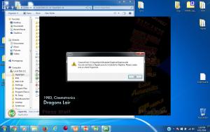

So i'm still a little new to hyperspin messing around here and there. So i have Dragon's lair working in rocketlauncher ui but when i launch through hyperspin i get this message, how do i fix it?
if you post your Hypespin Log
found in
YOUR DRIVE:\HyperSpin\Log.txt
you will probably see an error somewhere that says that Hypersin can't find Rocketlauncher and is using the default Hyperlaunch2
open your Hyperspin Settings Ini
YOUR DRIVE:\HyperSpin\Settings\Settings.ini
and make sure your path to Rocketlauncher is correct
if you are using Hyperspin 1.4
Hyperlaunch_Path=..\RocketLauncher\Rocketlauncher.exe
if you are uising Hyperspin 1.3.3
Thanks for the quick replies. I had hyperspin in the path in the settings.ini and rocketlauncher was in my c drive so it's working now. It exits fine, but launching it shows my desktop for a second or 2. So i have to figure that out. I think i got it thanks!!!
This may not be the right place to ask but i can't find the space ace or badlands themes. All the rest are there but those 2 are missing.
do you have the path vldp files in your frame file?
It should look something like this
\Emulators\Daphne\vldp\ace\
