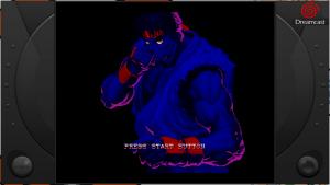

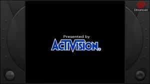

I posted this on the rlauncher forums too, but since it has to do with hyperspin as well, figured i'd try my luck here also.
So I made a bezel for the Dreamcast using Demul, and I got it looking fine launching from RL outside of Hyperspin. When it is then launched from within Hyperspin, there is a border of blank empty space all around it, which shows hyperspin behind it. I tried making the bezel a little larger and it still gets resized and put within this blank space all around it.  Any ideas why this is happening? Thanks.

Still blank in Hyperspin though.  Its as if Hyperspin is ignoring the Background that RL wants to draw to the screen, because the blank space is exactly how much is usually being filled by the RL background outside of Hyperspin.  I also don't know why the heck I'd even need to use a background as my bezels are my exact resolution (1920x1080).  Maybe it is something that is going wonky because i'm using Demul?  Because every other Bezel has been fine up until this one.
It almost looks like HS is running in a window that doesn't quite reach the edges.
You're 100% positive that your bezel doesn't have a transparent edge around it like it looks there?
Yeah it's completely flush with 1080x1920, in photoshop and in rocketlauncher.  There is no space in the file, it's crazy.  My hyperspin is set to fullscreen.  I think I may just chalk it up to this emulator having something that hyperspin itself can't translate from rocketlauncher, because like i said, every single bezel on every other system has worked just fine.  Unless some whiz can figure it out, I'm almost done trying lol.
