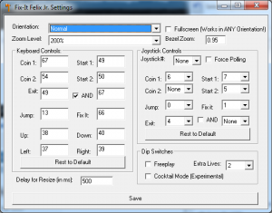

gigapig Posted December 15, 2014 Posted December 15, 2014 It has a mind of its own. You can open it and it is fine, close then open again and the game is small. oh well. I've actually been getting the same behaviour. To fix it I've mainly had to change the zoom level to 200% the it doesn't flit about into different positions every launch. Here's the new ones but they may not be any good for you.
