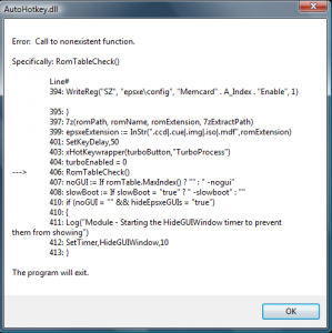

Updated AHK for ePSXe v1.9.0 and now i get errors
jimmyuk86
When try to i run ePSXe through hyperspin i get this error:
I havnt configured deamon tools as i dont want to use deamon tools with this emulator, so have disabled it in the HyperLaunch HQ settings.
Update all your files from git
Sent from my Samsung Galaxy S3 using Tapatalk 4.

22:05:07:012 | HL |     INFO  | +0     | BuildScript - Loaded Statistics.ahk script
22:05:08:012 | HL |     INFO  | +0     | BuildScript - Loaded User Functions.ahk script
22:05:08:012 | HL |     INFO  | +0     | BuildScript - Finished injecting functions into module
22:05:08:012 | HL |     INFO  | +0     | Main - Module is built

Is this better? Followed your guide on your post..thanks for that :)
logLevel = 10 is what you need to see. :)
This bit was interesting
22:05:29:998 | MD |     INFO  | +0     | Module - Tekken 3 (USA) is not a multi-disc game, so launching ePSXe with GUI disabled.22:05:29:999 | MD |   DEBUG1  | +0     | GetActiveWindowStatus - Title: The HyperNoobie Guide For Posting To The Fourm. - Mozilla Firefox | Class: MozillaWindowClass | State: 1 | X: -8 | Y: -8 | Width: 1296 | Height: 754 | Window HWND: 0x110288 | Process ID: 2540 | Process Path: C:\Program Files\Mozilla Firefox\firefox.exe
22:05:29:999 | MD |     INFO  | +0     | WinWait - Waiting for "ePSXe ahk_class EPSX"
But I'm no expert but I see nothing special in this log. Looks kinda normal. I've never had an instant load so can't comment as to you going from instant to 15 seconds as I'm used to things being a little delayed.
