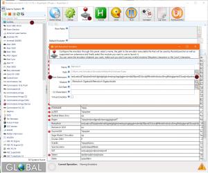

gigapig Posted May 10, 2016 Posted May 10, 2016 I have the same Rom so I know it's not the naming. You may having missing extensions from the list (see pic.) Add cue nearer the front of the list as RocketLauncher reads them in order.
kylecp1979 Posted May 10, 2016 Posted May 10, 2016 Make sure you have 7z turned on to true. Make sure you have rar extension in your group of extension to the emulator your using. and make sure inside your cue file it has the exact name of the bin file.
