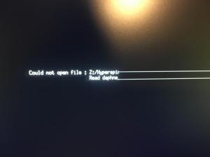

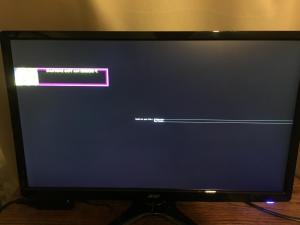

Jaydeekay Posted May 10, 2016 Posted May 10, 2016 Not sure what I'm doing wrong here but hopefully someone can help. Hyperspin & Rocketlauncher are fully updated I followed this guide setting up Daphne.... http://www.hyperspin-fe.com/topic/2161-complete-guide-for-daphne-in-hyperspin-and-RL/?hl=%2Bdaphne+%2Bhyperspin I'm about 99% sure I have this all set up properly, & can start every game on DaphneLoaders list except Thayer's Quest (no idea where to find the dvd) & 1 other game I can't remember right now. But when I try to start these up in Rocketlauncher to test I get this screen. 2nd shot just just a pic of the full screen, Upper left corner says Daphne got an error. A good chunk of the text is blanked out for whatever reason. Rocketlauncher is pointing to daphne.exe & not the loader plus my framefile directory. Rom Extension set to txt. Plus I went through & set all the bank0/bank1 #s Any idea what I'm missing here? Any help would be greatly appreciated.
Spawk Posted May 10, 2016 Posted May 10, 2016 My system doesn't have opengl so I had to change hardware acceleration from default to false in the global module settings. Maybe try that? Sent from my SGH-I337M using Tapatalk

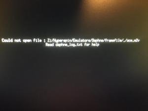

Jaydeekay Posted May 10, 2016 Author Posted May 10, 2016 Yeah, the framefiles match. Turning off hardware acceleration did let me see the full message though. I don't understand why it's looking there. The rompath is set to the framefile folder. Anyways, here's the log. daphne_log.txt

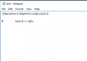

kylecp1979 Posted May 10, 2016 Posted May 10, 2016 I don't think you have your path in your framefile setup right I think you have it pointing to the wrong file. Here is what one of mine looks like
Jaydeekay Posted May 11, 2016 Author Posted May 11, 2016 Ok, is that the text file you have in your framefile folder? Mine just had a period on the top line. I typed in the path for mine there & still got the same error message. Edit: Nevermind, had to add the full path including drive letter & now its going. Trying with the rest now Edit 2: That did it. Roadblasters txt file is the only 1 that had it's path entered already. Rest just had a period. They all start in rocketlauncher now. Thanks!

kylecp1979 Posted May 11, 2016 Posted May 11, 2016 Not too sure here is my framefile for esh if that helps \Emulators\Daphne\vldp\esh\0 esh.m2v
snstay Posted May 11, 2016 Posted May 11, 2016 Holy crapkabobs it worked! i noticed i had a . in front of the 0 so i removed it and now it works. Thank you very much. couple more quick questions, i have scanlines enabled in daphne loader and they work there. They do not work however in Rlauncher and hyperspin. Any solution there? Also when i load the game in Rlauncher after the fade screen it gose back to Rlauncher for a brief second before the game begins. Can that be fixed. Thanks alot.
