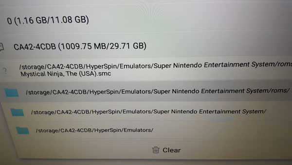

VaporDrake Posted May 20, 2016 Posted May 20, 2016 Hi everyone, i'm having a bunch of issues with Hyperspin and i don't even know where to start... I've put on the SD card a clean Hyperspin installation with just the Android fix and the Android_Settings Folder, The main menu looks like this: http://i.imgur.com/woXUanb.png On pc looks fine, so everything is in the right place. I tried to make the SNES work since it's one of the few that shows, imported my database with my romlist and my themes, visually everything seems ok but i can't get the rompath right, the whole Hyperspin installation is on a SD card (32GB SanDisk http://ecx.images-amazon.com/images/I/41HHaOvRAqL.jpg ). For some reason the device decided to name the SD card like this: (this is from ES file Explorer on the shield TV showing the path to the rom folder) Every time i format the SD card from windows the name changes, and i've tried basically everything, /storage/sdcard1, /storage/sdcard0, /storage/sdcard, /storage/CA42-4CDB, nothing works. The games load fine on Retroarch with no issues. The games are unzipped and I've edited the settings file accordingly. Tried with both HyperSpin 1.3 and 1.4 (if that makes any difference) I'm basically lost... any ideas?

reznnate Posted May 21, 2016 Posted May 21, 2016 It's possible the capital S in HyperSpin is throwing things off but I don't know. The "CA42-4CDB" represents the UUID of that drive volume. Both of these should work for you: rompath=Emulators/Super Nintendo Entertainment System/roms/ or rompath= /storage/CA42-4CDB/Hyperspin/Emulators/Super Nintendo Entertainment System/roms/ In case of second example, Hyperspin app will auto-search-find and prefix the path with /storage/CA42-4CDB/Hyperspin/.... I suspect you have the wrong file extension (or something like that).
loueradun Posted May 21, 2016 Posted May 21, 2016 If the sdcard is formatted as fat32 the case shouldn't matter. If its formatted as exFAT, or EXT they are case sensitive.
