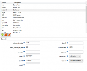

Metalzoic Posted May 24, 2016 Posted May 24, 2016 Looks like there aren't as many options in the module settings as I remembered, maybe some of the Daphne settings do carry over then? My Global Parameters are vldp -blank_searches -noissues -fastboot here's my badlands settings. It says I'm running Badlands prototype... maybe that's what I was thinking when I was talking about the sound option? My new advice is ask Ron in the Daphne tutorial thread. He'll probably know.

badhemi Posted May 24, 2016 Author Posted May 24, 2016 On 5/24/2016 at 2:19 PM, Metalzoic said: Looks like there aren't as many options in the module settings as I remembered, maybe some of the Daphne settings do carry over then? My Global Parameters are vldp -blank_searches -noissues -fastboothere's my badlands settings. It says I'm running Badlands prototype... maybe that's what I was thinking when I was talking about the sound option?My new advice is ask Ron in the Daphne tutorial thread. He'll probably know. Capture.PNG Thanks I'll check mine out
badhemi Posted May 24, 2016 Author Posted May 24, 2016 On 5/24/2016 at 2:19 PM, Metalzoic said: Looks like there aren't as many options in the module settings as I remembered, maybe some of the Daphne settings do carry over then? My Global Parameters are vldp -blank_searches -noissues -fastboot here's my badlands settings. It says I'm running Badlands prototype... maybe that's what I was thinking when I was talking about the sound option? My new advice is ask Ron in the Daphne tutorial thread. He'll probably know. Capture.PNG # pauseOnExit - If true, will pause Daphne before exiting by sending "P". If your monitor is not the same resolution as daphne, Fade_Out will not display correctly. Pausing Daphne tries to prevent this. # -noissues is for Esh's Aurunmilla. It stops daphne's warning about issues at launch. # -fastboot is for Dragon's Lair and Space Ace, It skips the self test in the beginning. # version - see version info below each game [settings] globalParams = vldp -blank_searches -prefer_samples -fullscreen -noissues -opengl -fastboot -x 1024 -y 768 pauseOnExit = false [ace] min_seek_delay = 1000 seek_frames_per_ms = 20 homedir = . bank0 = 00000010 bank1 = 00000001 bank2 = bank3 = sound_buffer = 2048 params = -useoverlaysb 1 version =ace # Rev A3 = ace # Enhanced v1.0 = sae # Rev A2 = ace_a2 # Rev A = ace_a [astron] min_seek_delay = seek_frames_per_ms = 20 homedir = . bank0 = 00000000 bank1 = 00000000 bank2 = bank3 = sound_buffer = 2048 params = version = astron # Astron Belt (Hitachi) = astron # Astron Belt (Pioneer) = astronp [badlands] min_seek_delay = 1000 seek_frames_per_ms = 20 homedir = . bank0 = 00000000 bank1 = 10000011 bank2 = bank3 = sound_buffer = 2048 params = version = badlands # Standard = badlands # Prototype = badlandp [bega] min_seek_delay = 1000 seek_frames_per_ms = 20 homedir = . bank0 = 00000000 bank1 = 00000111 bank2 = bank3 = sound_buffer = 2048 params = version = bega # Revision 3 = bega # Revision 1 = begar1 [cliff] min_seek_delay = 1000 seek_frames_per_ms = 20 homedir = . bank0 = 00000000 bank1 = 01000000 bank2 = 00000000 bank3 = 01111011 sound_buffer = 2048 params = version = cliff # Standard = cliff # Alternate #1 = cliffalt [cobra] min_seek_delay = seek_frames_per_ms = 20 homedir = . bank0 = 00000000 bank1 = 01001000 bank2 = bank3 = sound_buffer = 2048 params = version = cobraab # Astron Belt Hardware = cobraab # MACH 3 Hardware = cobram3 # Dedicated / Bega's Battle Hardware = cobra # Cliff Hanger / Interstellar / Dragon's Lair Conversion = cobraconv [esh] min_seek_delay = seek_frames_per_ms = 20 homedir = . bank0 = bank1 = bank2 = bank3 = sound_buffer = 2048 params = version = esh # Standard = esh # Alternate #1 = eshalt # Alternate #2 = eshalt2 [galaxyr] min_seek_delay = seek_frames_per_ms = 20 homedir = . bank0 = 00000000 bank1 = 00000000 bank2 = bank3 = sound_buffer = 2048 params = version = galaxy # Hitachi = galaxy # Pioneer = galaxyp # Star Blazer = blazer [gpworld] min_seek_delay = seek_frames_per_ms = 20 homedir = . bank0 = bank1 = bank2 = bank3 = sound_buffer = 2048 params = version = gpworld # Standard = gpworld [interstellar] min_seek_delay = 1000 seek_frames_per_ms = 20 homedir = . bank0 = 00110001 bank1 = 00000000 bank2 = bank3 = sound_buffer = 2048 params = version = interstellar # Standard = interstellar [lair] min_seek_delay = 1000 seek_frames_per_ms = 20 homedir = . bank0 = 11011001 bank1 = 00100111 bank2 = bank3 = sound_buffer = 2048 params = -useoverlaysb 1 version = lair # Rev F2 = lair # Enhancement v2.1 = dle21 # Enhancement v1.1 = dle11 # Rev F = lair_f # Rev E = lair_e # Rev D = lair_d # Rev C = lair_c # Rev B = lair_b # Rev A = lair_a # Beta 2 = lair_x # Beta 1 (serial #1) = lair_n1 [lair2] min_seek_delay = seek_frames_per_ms = 20 homedir = . bank0 = bank1 = bank2 = bank3 = sound_buffer = 2048 params = version = lair2 # Version 3.19 = lair2 # Version 3.19 (European) = lair2_319_euro # Version 3.19 (Spanish) = lair2_318 # Version 3.18 = lair2_318 # Version 3.16 (European) = lair2_316_euro # Version 3.15 = lair2_315 # Version 3.14 = lair2_314 # Version 3.00 = lair2_300 [mach3] min_seek_delay = 1000 seek_frames_per_ms = 20 homedir = . bank0 = 01000100 bank1 = bank2 = bank3 = sound_buffer = 2048 params = version = mach3 # Standard = mach3 [rb] min_seek_delay = 1000 seek_frames_per_ms = 20 homedir = . bank0 = 00000000 bank1 = 00000001 bank2 = bank3 = sound_buffer = 2048 params = version = roadblaster # Standard = roadblaster [sdq] min_seek_delay = 1000 seek_frames_per_ms = 20 homedir = . bank0 = 00100001 bank1 = 00000000 bank2 = bank3 = sound_buffer = 2048 params = version = sdq # Standard = sdq # Shortened Scenes = sdqshort # Shortened Scenes, Alternate = sdqshortalt [tq] min_seek_delay = seek_frames_per_ms = 20 homedir = . bank0 = bank1 = bank2 = bank3 = sound_buffer = 2048 params = -useoverlaysb 1 params = version = tq # Standard = tq # Alternate = tq_alt # 'Swearing' ROM Hack = tq_swear [uvt] min_seek_delay = seek_frames_per_ms = 20 homedir = . bank0 = 00000000 bank1 = bank2 = bank3 = sound_buffer = 2048 params = version = uvt # Standard = uvt
