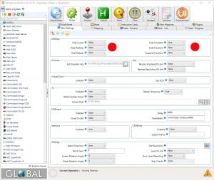

gigapig Posted May 23, 2016 Posted May 23, 2016 Do you have "Hide Emulator set wrong in RLUI? Or it may be linked to bezels.
pagman27 Posted May 23, 2016 Author Posted May 23, 2016 What you mean? I know there was a similar problem before and I had to change d3d to draw, worked for a bit but then has stopped....The music is playing behind the black screen....All other emulators are working fine.
pagman27 Posted May 23, 2016 Author Posted May 23, 2016 So are you saying that these are the settings I need? my hide emulator says false

gigapig Posted May 24, 2016 Posted May 24, 2016 Can I add this happened after updating to RocketLauncher.......doh probably should have mentioned that earlier :-( While visiting the doctor the doctor asks you "what appears to be the problem?" With eyes watering you say "Doc, my asshole is really hurting", so the doc sticks his fingers up your ass and finds no problem. As his gloved fist slides from your gaping hole the doc notices a boil on your ass cheek the size of a golf ball. Perhaps one failed to mention this on purpose. So are you saying that these are the settings I need? my hide emulator says false You best try it and see, or check the module settings for changes.
