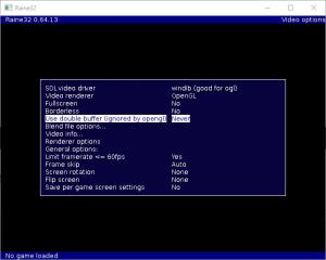

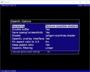

gigapig Posted June 8, 2016 Posted June 8, 2016 Cold ones been sent! Thanks buddy, I was gagging for a cold can of Special Brew. Luckily it wasn't the shader code that was the problem just some fine turning of the emulator, see settings below. I did force the full screen res to 640x480 in the config.
