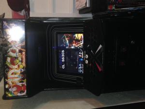

So I've got my little shinobi cab... But wanting more
I've got it dialled it for the most part, but really don't like the tankstick. I want to build a CP, and upgrade my PC.... Basically an overhaul.
I'm thinking of doing a 4 player w/trackball but does the ultimate I/o support 4 player or do you just buy the expansion harness?
Also thinking about " widening" the current cab to accept a wider monitor. Don't know how a large 4 player cp would look on this smaller cab?
Lots to learn as I've been digesting a lot of info, but now that I know HS and my setup well I think it's time to make the jump?? Looking for input / thoughts etc.

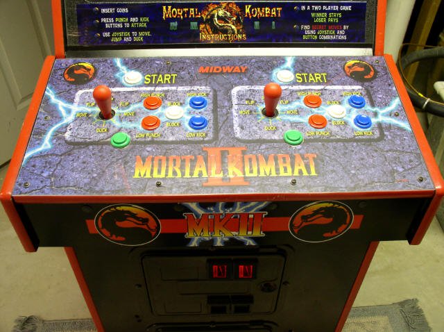

judging from everything you wan to upgrade,  I think you are better of selling your current cab and  building a new better cab.
an MK 2 cab  with a bigger control panel
MK%202%20CPO%20w%20%20New%20T%20Molding.
or similar cab such as a Golden Tee will work better for you if you want  a 4 player + trackball.
you can find the plans all over the web

and the ultimate i/o  has 48  inputs  96 outputs
assuming
per player
(4) joystick + (8) buttons
you would need a secondary encoder if you wanted to have dedicated service keys such as Esc,Enter, P1-4,  and coins.
Def want to have some admin buttons up too, the goal is to not have to access a PC via mouse/keyboard if possible.
I can rebuild another cab, cut some wood up... Just thinking I already have 90%, I could just modify to fit some new things
Well, if you don't need 8 buttons for all 4 players you could spare some for admin. I've seen a lot of cabs with 8 buttons for player 1 & 2 and 6 buttons for player 3 & 4. Or even 6 buttons for all...depending on your needs. Or 7 buttons for all players. Anyway you would get at least 4 admin buttons. And the PC power on button is connected directly to the motherboard so that would give you 5 admins. But it might not be enough anyway for you.
