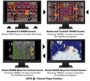

I'm not sure what you consider to be  a 4 player cocktail cabinet.
I can tell you for a fact,  that playing 4 player games on a cocktail cabinet sucks!!!!!.  the viewing angle   on the cocktail side controllers sucks for games such as, Simpsons TMNT, Avengers ect.
the only 4 player game you can play with out terrible viewing angles  is Demolition Derby (on MAME)  And you still don't have the correct view on player 3-4
if you are planing to build a cocktail cab to play Upright games such  Contra,  Most of the Shooter Games found in Cave or MAME such as the 14xx series.
You can pretty much throw out that Idea.  If you still think its a good idea, You will have to use the split screen for all the 2 player Upright games.
Standard 4:3  = all your Standard screen games found in MAME or other systems,  they will be controlled by the 3rd control panel.
Rotate and Cocktail Mame : all your Upright 2 Player Games (you can't have player 2 looking at an inverted screen)
I did not rotate any of this games and they are controlled with the 3rd control panel. The un-rotated screen is bigger than the spit screen.
from the image  MK game,  you can see the problem with not adding the 3rd control panel. 2 payer games will not work on a cocktail cab. Unless you use the split screen.
and as far as I know only MAME supports the Split Screen video mode. ALL other 4:3 systems will be unplayable without a 3rd control panel.
Rotated MAME =  Cocktail supported games (games that support flip screen)
my joysticks are numbered as following
3rd Control Panel = Player 1 and PLayer 2 -->  this supports all the 4:3 games found in MAME or any other system.
Cocktail Left Controller = Joystick 3 -->   this ONLY supports all the Player 1 MAME cocktail (Flip screen) supported games
Cocktail Right Controller = joystick 4 --> this ONLY supports all the Player 2 MAME cocktail (Flip screen) supported games
by default all the cocktail games will be mapped to joystick 1 (P1) and joystick 2 (P2)
,you will have to manually remap all the cocktail games to the Joystick3-Joystick4 controls or the keyboard keys you assigned to those buttons (don't use the default MAME P3-4 keys).
