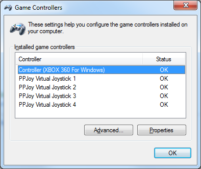

majorspawn Posted July 4, 2016 Author Posted July 4, 2016 ok i think i know what the problem might be, (ill test tonight) When you have a setup that has both a keyboard and a gamepad connected player 1 defaults to the game pad and keyboard becomes the player 2. Hence why it doesn't work when you startup the game. I also have a 4snes4nes with 2 snes pads, unfortunately nothing is connected to the 1/2 snes game port as per standard install disgram so the game might be looking for a input on these, I have port 3 and 4 always connected. might not be able to hit enter on the pad. Looking on the above picture as an example does anyone know if its possible to disable the game controller service or specific game controllers in windows? For example disable the highlighted xbox and joystick 1 controllers (1 and 2)? OR Swap the order these are assigned?, e.g swap controller 4 with controller 1? My Arcade Projects: SNES PC Project Vewlix Cabinet LS-30 Rotary Joysticks
majorspawn Posted July 4, 2016 Author Posted July 4, 2016 ok guys, this was the cause as i predicted. When you have a permanently connected controller to your setup Darius assigns player 1 controls to the first joystick in you game controllers list and player 2 defaults to keyboard controls. As i am running this on a snes pc with the raphnet 4nes4snes adapter with a standard wire config the 2 front snes ports use the 3 and 4 port leaving port 1 and 2 unused. Unfortunately Darius assigns to port 1. So to fix this you wire a non standard wiring to the alternate ports or disable the first 2 controllers in device manager. This fixed the issue. @Metalzoic, what tutorial did you have mate? hope it helps someone Cheers MS My Arcade Projects: SNES PC Project Vewlix Cabinet LS-30 Rotary Joysticks
