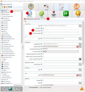

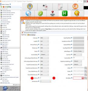

gigapig Posted July 25, 2016 Posted July 25, 2016 Just a quickie but im trying to use the SSF ver 0.12 emu for sega saturn but everytime i try and open it to use config it opens in a tine tine box in top left corner then disapears so cant run any games, it keeps asking me to choose virtual drive in config but cant get to it You've installed Daemon tools lite? You have set the CD Drive based on your system? Mine in the example is set to 2 because I have a DVD drive, a Blu-Ray drive and the virtual drive. You may also need to set your drive letters for the virtual drive, if you don't know it mount an image file in DT Lite and it will tell you.

GMT Posted July 25, 2016 Author Posted July 25, 2016 You've installed Daemon tools lite? You have set the CD Drive based on your system? Mine in the example is set to 2 because I have a DVD drive, a Blu-Ray drive and the virtual drive. Image 1.jpg You may also need to set your drive letters for the virtual drive, if you don't know it mount an image file in DT Lite and it will tell you. Image 2.jpg Thanks bud I'll check that out, I'll get back to you
GMT Posted July 25, 2016 Author Posted July 25, 2016 hey bud yep ive done all that but everytime a game loads it says i need to enable the virtuall drive in ssf and i cant get in there.
