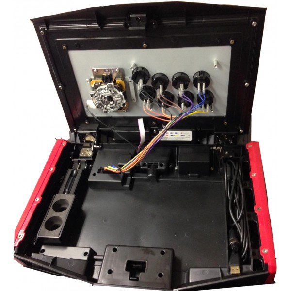

32assassin Posted July 23, 2016 Posted July 23, 2016 Thanks for the reply, I could remap all the controls but i have a full setup with a lot of games including Pc games, plus cfg files set up for each of my separate roms, I could remap all the controls but then the setup would not work correctly with 360 controllers, also this would be a massive job and surely the stick should just work the same as a 360 controller seeing as it uses the same drivers etc, Surely there must be a workaround?? if you are set on using your current cfg files, Open your new controller, if it looks like this you might be able to switch a few wires to match the layout you want if not you are pretty much forced to rebuild a second set of cfg files or get another controller that matches your cfg files.
pjbridger Posted July 24, 2016 Author Posted July 24, 2016 Thank you for the replies, @32assasin - Oh my god I cant believe i didn't think of that! Swapped over the wires, now working perfect! Thanks soo much!!!!
