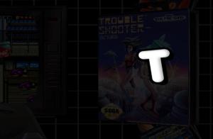

RobertBlum Posted September 9, 2016 Posted September 9, 2016 Hello, when I'm in the game wheel and hold down the left or right key, its shows the alphabetical letters. So its easy and faster to jump to the desired game. My problem is, all the systems i added/created manually the letter function dont work. When i press down the left or right key, nothing happens. Beside that everything else works normal as on the other systems. As I said, it only happens to the systems i created manually. The pre-configured systems work without this problems. The new systems i added directly in HyperlauchnHQ. I already checked the letters folder. The images are inside. Does somebody know what could be the problem? Thanks, Robert

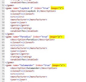

Spawk Posted September 10, 2016 Posted September 10, 2016 The XML for those systems need to have the "image" tag edited. Just the first game of each letter... Check other xmls to see what I mean. Sent from my B3-A20 using Tapatalk
RobertBlum Posted September 10, 2016 Author Posted September 10, 2016 The XML for those systems need to have the "image" tag edited. Just the first game of each letter... Check other xmls to see what I mean. Sent from my B3-A20 using Tapatalk Thanks for your reply. The image tags were written in the xml automatically as the database was created. The letter Images are in the system media folder. (\Hyperspin\Media\NEC TurboGrafx-16\Images\Letters) What else could be the problem?
