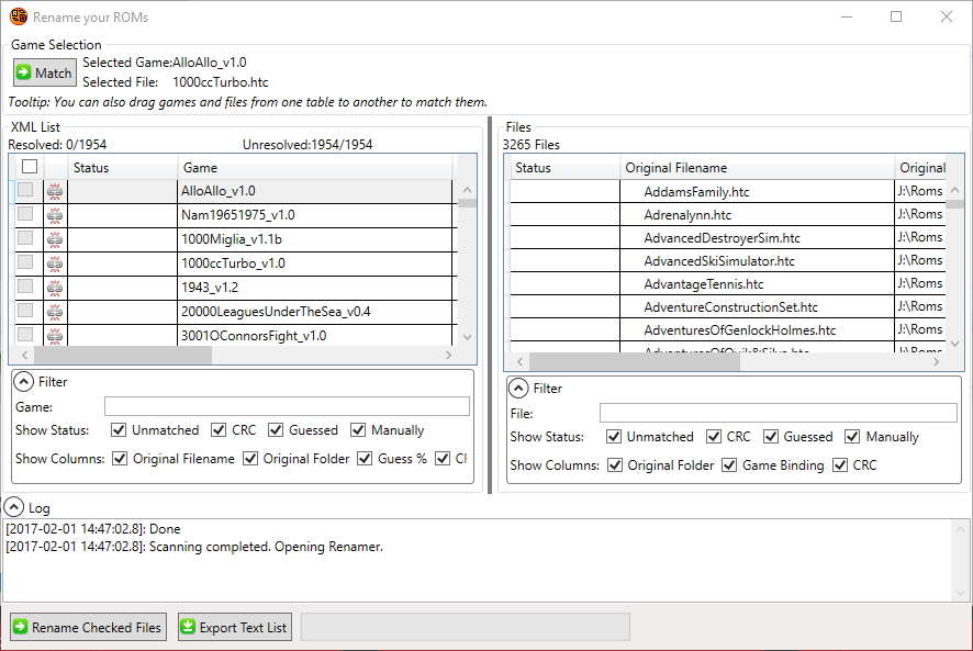

gigapig Posted February 1, 2017 Posted February 1, 2017 On 30/09/2016 at 7:06 PM, Styphelus said: I got the WHDload set from PD. It's from January 2016. I'm more worried about the artwork. I got the roms almost all renamed but I have over 2000 wheels, videos, 2D covers, 3D covers and disks. 980 games in each of those need renaming. Did you ever get them renamed? I tried Dons which resolved nothing and I left Tur-Matcher running last night and it also did not work (although I did leave the settings at default.)

kenss3 Posted February 8, 2017 Posted February 8, 2017 i am having same issue and i seem to have figured it out... i made a hyperlist of the all the video files, then i used Dons tool to rename all my roms to match the hyperlist (which has all the correct names based on video files) and create new roms in a seperate folder (just in case something went wrong). looks like it works except i need to delete a lot of the duplicate roms that i have so that it chooses the best one (when sorting through the hyperlist) if you do it this way, after all completed... then you need to remember to create a new hyperlist for the roms you just renamed and save in hyperspin/database folder with correct name
