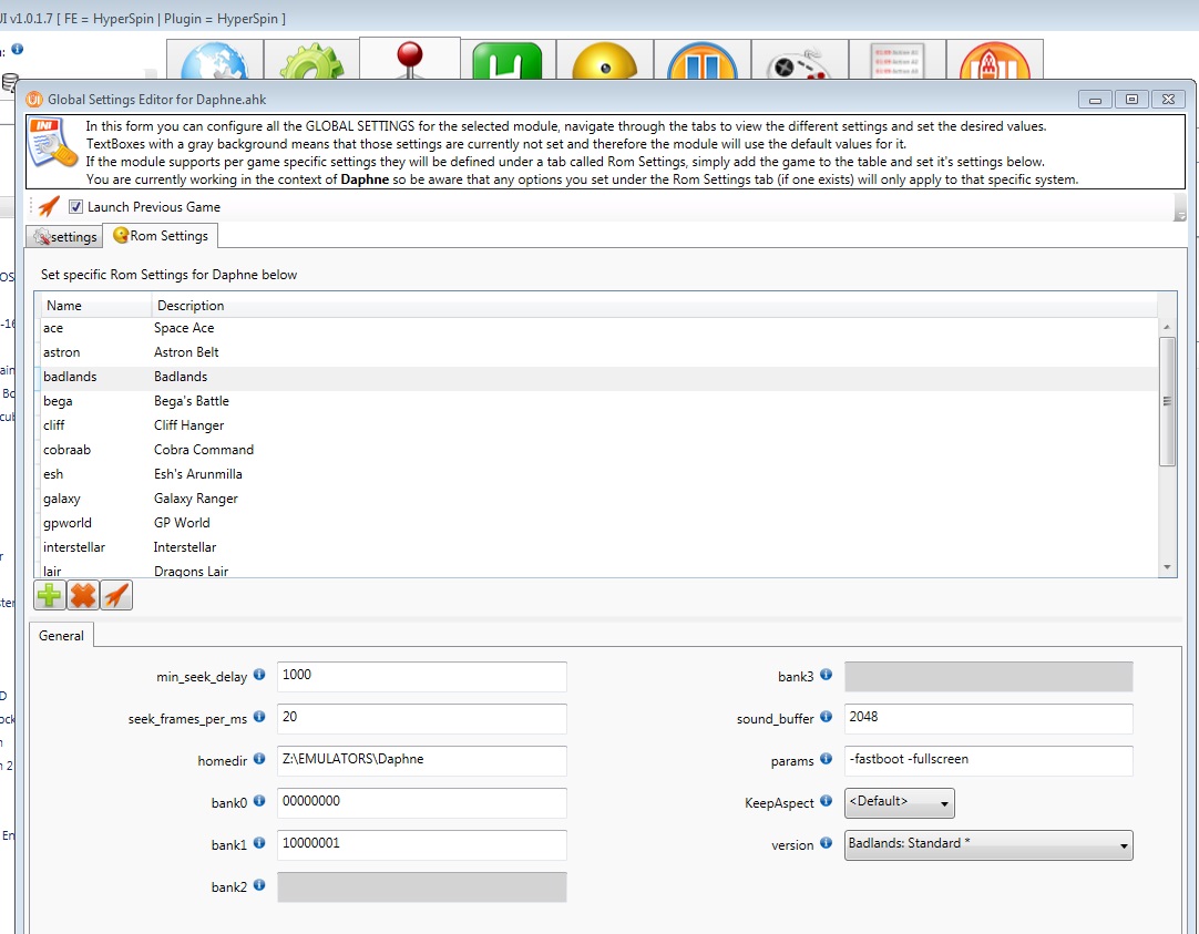

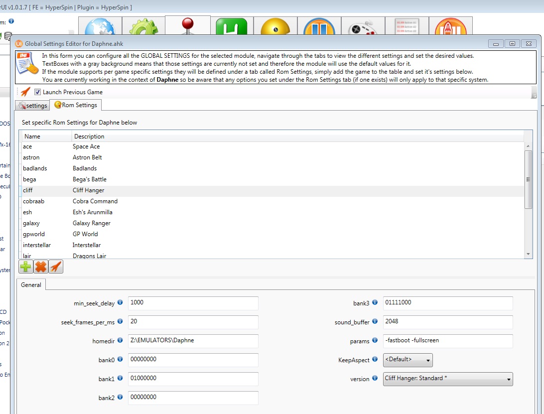

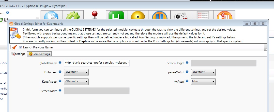

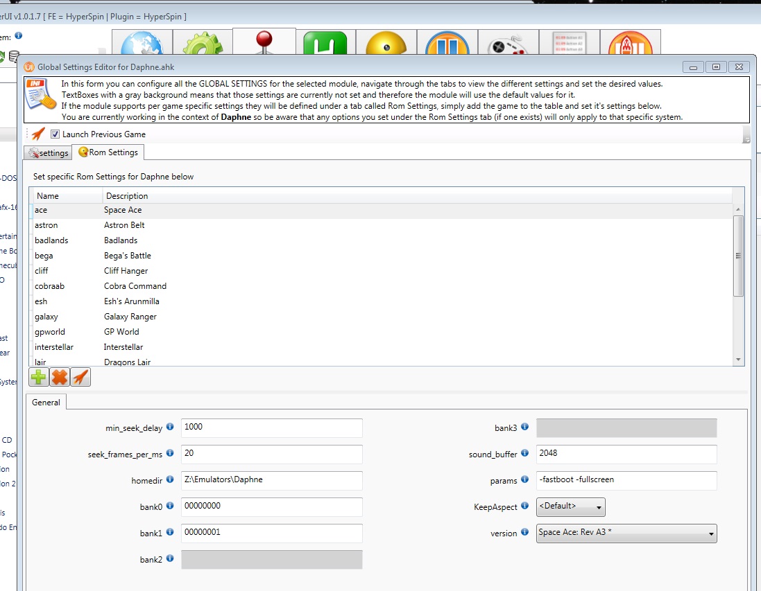

Spawk Posted October 7, 2016 Posted October 7, 2016 Ok there is probably a better tutorial here somewhere but for quick reference here is a brief look at how I set up daphne in RL. Not even sure if Hyperlaunch has any of this stuff, it's been so long. Maybe this will be helpful to other readers or if the OP wishes to update. 1. Rompath should point to the framefiles (.txt extension). Now I should explain that these framefiles usually reside in the vldp folder along with the rest of each games files. I had issues with rocketlauncher finding these files for it's audit so I created a "framefile" folder and copied all txt files from each games folder into it. This should give you all green audit. The path has changed now though so you need to open each txt file and change the top line from: .\ to: ..\vldp\"Game Name" All this may not be absolutely necessary. You may be able to just point the rompath to the vldp folder and set rom skipcheck or something. It won't audit green but RL will find the files. I am a bit of a stickler for that kind of stuff so I wanted my audits to work. The above was a very quick and effective solution. 2. From "Modules" click "Edit Global Module Settings". * Under "globalParams" after the last dash is "fastboot" (hidden) * My system does not have opengl so I had to turn hwAccel off, you may or may not be able to leave this on true. For the record, these are not very graphically intensive games and I noticed no slowdown whatsoever with this off. 3. Click on the "Rom Settings" tab from same global module settings. For every single game, you must input all command line options. Here are some samples of the games you mentioned. Space Ace: Badlands: Cliffhanger: This will allow rocketlauncher to pass the exact command line options needed for each game to run properly. Whatever you have configured in Daphne Loader is irrelevant. It's been a while since I set this up, if anyone notices I missed anything, let me know.
