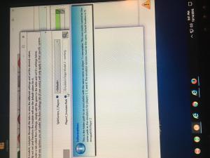

thenoob Posted October 15, 2016 Posted October 15, 2016 Ok I'm close real close I've got Daytona able to boot up, ask me 1-4 player, get to game, but then player 2 controls don't work....although I've got it to gameplay and the screens are split What gives? I've used 2 player all the time in model2, controls are good. In the pic attached I'm confused by the last sentence "the default location is %emupath blah blah... What seems to be the issue. It would be very nice to play 2 player Daytona

Yeuxkes Posted October 15, 2016 Posted October 15, 2016 I also recently set up the multiplayer modes for Model2 and from what I remember is that you can only use keyboard controls for Player1. For all the other players you have got to setup their defaults controls to be from a gamepad or wheel. Seems like you are confused by the Player 1...4 part and how to set it up. In the module notes it says you need to have SEPARATE emulators for each player. That's why you have those options to point to these emupaths. The help text as you elegantly quoted "the default location is %emupath blah blah..." just points to the location where you have the different players emulators. Because the games work in netwerk, there really is no player 2, 3 or 4, they all are player 1 but linked together. Master game is player 1 while the slaves are player 2-4 Hope this helps you out.
thenoob Posted October 15, 2016 Author Posted October 15, 2016 I've got separate emulator folder for player 2, it's right below my original one in my emulator list. Setting up controls is also kind of a pain.... I've got a tankstick. What's also happening is its not synching properly as. Well, and entering the game together...I can't see the other players car....is that the limitation with the multiplayer? That it's basically just two instances of the game and the two cannot truly play together (pass/smash into each other etc) Is there anything in f2, like changing player 1 to master or anything like that or did yours automatically synch?
Yeuxkes Posted October 15, 2016 Posted October 15, 2016 I've got separate emulator folder for player 2, it's right below my original one in my emulator list. Setting up controls is also kind of a pain.... I've got a tankstick. What's also happening is its not synching properly as. Well, and entering the game together...I can't see the other players car....is that the limitation with the multiplayer? That it's basically just two instances of the game and the two cannot truly play together (pass/smash into each other etc) Is there anything in f2, like changing player 1 to master or anything like that or did yours automatically synch? No you can actually race with up to 8 players if you open up 8 different emulators, but RL limits to 4 max. Make sure link is enabled in Rocket launcher. In the F2 screen you need to set up player 1 as the master and all the others as slave. I also have the cabinet set to deluxe model, and a different car number for each player but don't know if this makes a difference in the end.
