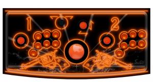

Polemicist Posted March 10, 2014 Posted March 10, 2014 If the top left is not included then the bottom right is a thumb button for that layout albeit an uncomfortable one. therefore that would most likely end up as 7 but you have to think about comfort with gameplay. http://forum.arcadecontrols.com/index.php?topic=100513.0 If you look at the posts in that topic you will see this picture For many people that would be comfortable but it depends on the game. You can configure keys individually for every single game you play as well. The most important thing isn't assigning the keys but deciding on how you will use those keys to play the games.
