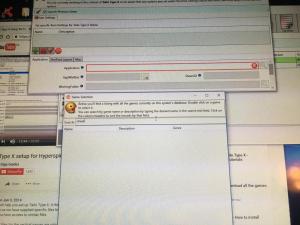

thenoob Posted October 20, 2016 Posted October 20, 2016 Hey guys For those who have success with giga's video (he's awesome btw) and have got it successfully running in RL I am stuck. I've been able to follow the video until editing the module. Because the video is done in hyperHQ it's quite a bit different there. What I did: Download giga's link to everything on the video. Dragged the games folder into my rom's directory. Setup the the HQ wheel correctly Wheel/system shows up fine in RL PcLauncher ticked to virtual drive Go to taito /modules click pclauncher / edit global module settings No games show up in list. The screen is different than HQ, I have a red rectangle around the "application" box. Now pclauncher is new to me, do you actually have to download this PClauncher or I assume it's just built into Windows...just means windows launches the game. Maybe...the folders of the games that the games are sitting are the same ones that's included in giga's mega file. Do the games folders have to be renamed? Pic attached.... Might be too much info but I can't follow his video after this point as RL is a bit different to what his says.

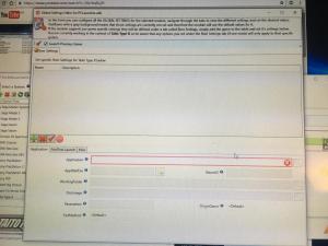

thenoob Posted October 20, 2016 Author Posted October 20, 2016 But when I click that green plus sign, This box comes up... I type in it , nothing happens etc, search functions does nothing.
thenoob Posted October 20, 2016 Author Posted October 20, 2016 Found out When I was dragging my xml over, Finger got a bit clicky and dropped into the wrong folder... Good to go!!!! Had to be something simple

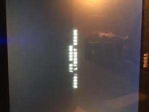

thenoob Posted October 20, 2016 Author Posted October 20, 2016 Ahh this is frustrating Rocketlauncher gives me this, launching from the pointed to batch file in the folder Should this giga set work good outside rocketlauncher? Because I keep getting a library 0000 error.
thenoob Posted October 20, 2016 Author Posted October 20, 2016 Fades set to false Don't know what else it could be. Running Windows 10, every other system I have is running great... When trying in stand alone mode, no games load just this screen :

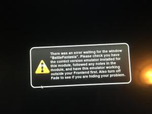

thenoob Posted October 20, 2016 Author Posted October 20, 2016 So I've pretty much got rocket launcher to launch street fighter iv, I had to use simply Austins link for it to go except: Game loads, get to character select screen and rocket launcher just minimizes to a tiny screen and gives me the same window "there was an error waiting for the window street fighter 4, blah blah" The game continues to run in the desktop, just shows minimized. Anjdowjfnxkjchsmevsjcuwjdkdk!! It's the only game I truly want from this collection
Tomkun Posted October 20, 2016 Posted October 20, 2016 On 10/20/2016 at 1:53 AM, thenoob said: Fades set to false Don't know what else it could be. Running Windows 10, every other system I have is running great... When trying in stand alone mode, no games load just this screen : That screen shows that you are loading the game executable and not the game loader.
pinsanity Posted October 20, 2016 Posted October 20, 2016 Make sure the application is pointing to the bat file for that game, not the exe. Also under the rom settings pic you posted earlier the AppWaitExe text box needs to be filled out for that game or you will get that timeout error whilst RL thinks it is still waiting for the game to load. Some TTX games need it and some don't. For Street Fighter 4 the text to add to the AppWaitExe box is game.exe
thenoob Posted October 20, 2016 Author Posted October 20, 2016 I figure it would be better to make a video to show you what it's doing. I've gone through the the video a few times followed directions but RL is still giving me this weird minimized window. Does it inside hyperspin as well.
gigapig Posted October 20, 2016 Posted October 20, 2016 If the app wait does not work like pinsanity mentioned then try the fadetitle. The were all included in the mega link you used and you will find them in the pclauncher.ini
thenoob Posted October 20, 2016 Author Posted October 20, 2016 I think I'm going to start over and try again. I had the application pointed at the batch file which I thought was the correct thing to do. I am confused about the appwait so the best thing to do is start over and go slow. Thanks for the help, will re-attempt later today!!
