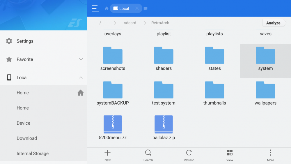

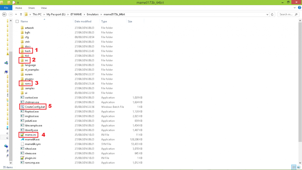

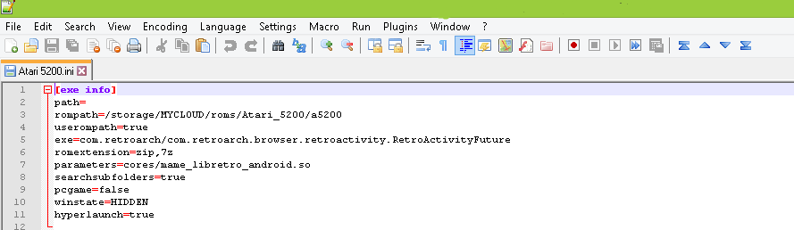

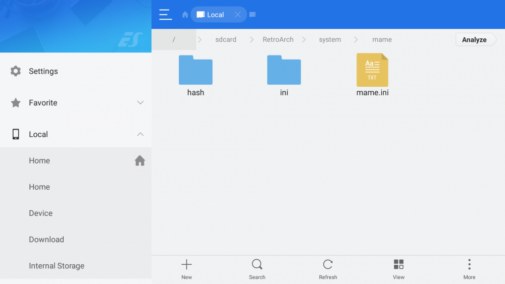

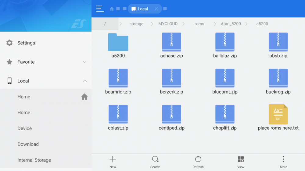

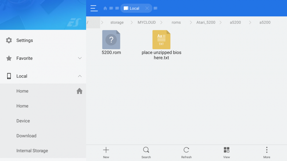

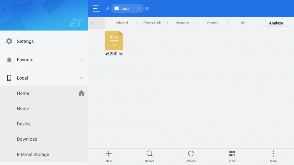

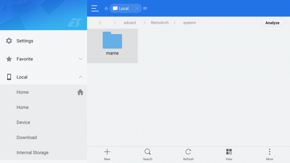

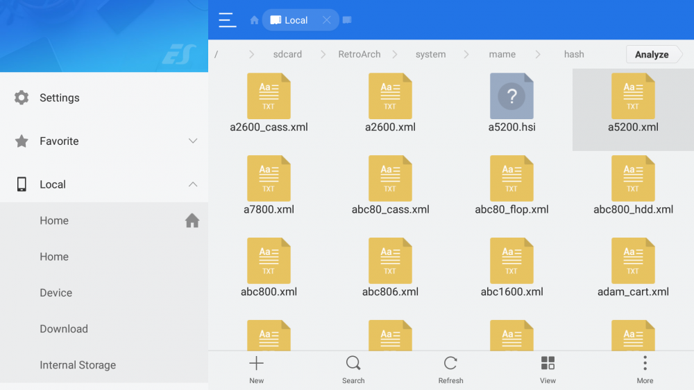

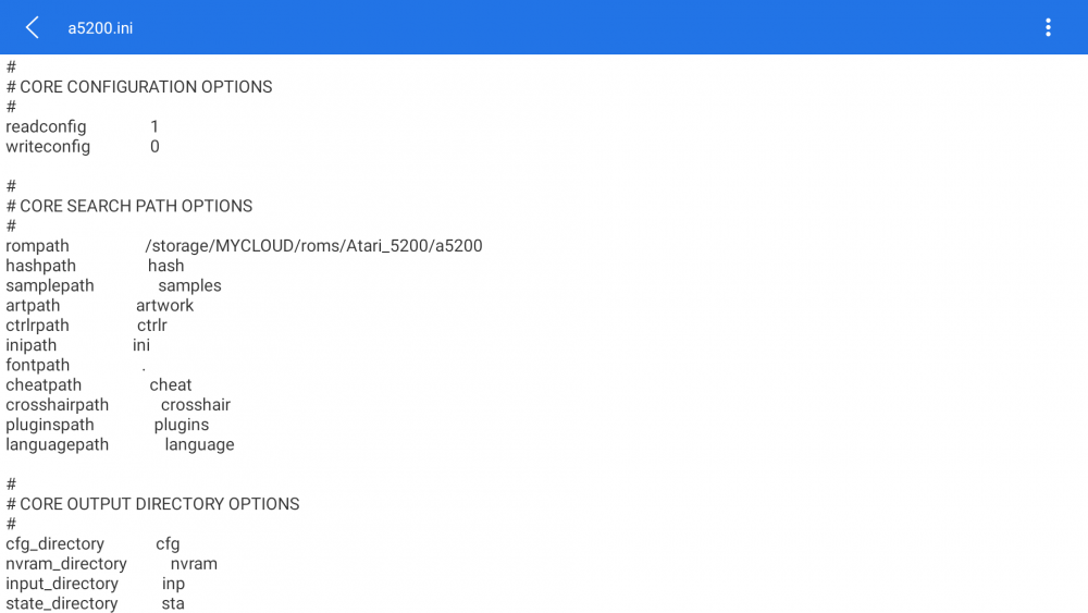

thatman84 Posted November 3, 2016 Posted November 3, 2016 MAME Atari 5200 Setup with RetroArch Android How to get Atari 5200 and other systems working on Nvidia Shield with Retroarch “Arcade (MAME)” core Limits Everything RetroArch is subject to change without warning, cores break and improve and RetroArch is constantly evolving. The exact same goes for MAME but this is more consistent. You must have the correct roms and BIOS files that MAME emulator is expecting. · They must all be named as MAME requires Note I have assumed you are familiar with setting systems up in Hyperspin and are familiar with Retroarch. Native RetroArch and RetroArch launched from Hyperspin use separate configuration files. Please search around for the topics relating to this issue. Tested on:- · Nvidia Shield TV PRO v3.2 · RetroArch 1.3.6 Stable Play Store app · Arcade (MAME) Core 0.174 (Also known as MAME Git core) What’s Covered... Getting Atari 5200 setup to work with Hyperspin Start to Finish!! Quick Steps... Grab the PC version of MAME and extract the files and folders Place your roms and BIOS in the correct place Set your RetroArch System/BIOS directory Build your RetroArch “System/BIOS” directory with above files/folder Create a5200.ini and adjust the rompath (not needed in mame 0.181) Adjust your Hyperspin Atari 5200.ini rompath to match Full Details... Step 1 – Let’s get the MAME files Download and extract the PC version of MAME emulator. Try to match your romset version, RetroArch “Arcade (MAME)” core version and PC MAME emulator version. RetroArch is usually a couple of releases behind. For the current release go HERE For previous releases go HERE Once extracted you will have something similar to this There is plenty more there than this guide will cover!! Next copy the highlighted assets to a safe location 1) Hash folder – This has the MAME games databases (softlists) for all the different non Arcade systems MAME can emulate 2) Ini folder – All specific and global configuration (.ini) files go in here 3) Roms folder – All Arcade BIOS files go in here 4) mame.ini – This is the Global configuration file for MAME 5) CreateConfig.bat – This is an optional file to generate the mame.ini file If you don’t have a mame.ini you will need to generate one Open Notepad and type the “name of mame.exe” –cc Example mame64.exe –cc Save it as CreateConfig.bat (Locate it with your mame.exe) (OR USE THIS mame64.exe CreateConfig.bat) Double click the Batch file and mame.ini will be created Step 2 – Organise your roms & BIOS I have my roms located on a NAS drive called “MYCLOUD”. Wherever you locate your roms they must end up in a subfolder called “a5200” Your compressed BIOS folder (a5200.zip) can be located WITH you ROM file zip's /ROMPATH/a5200 - place zipped BIOS and zipped roms here /ROMPATH/a5200/a5200 - Place UNzipped BIOS files here An additional a5200 folder with the Unzipped BIOS files can also be place in the a5200 folder Your roms and BIOS will need to match what’s in the a5200.xml in the “hash” folder This means whatever roms and BIOS you have MUST be named the same as the name given in the hash file. Note To automate the renaming process you can grab the MAME Atari 5200 Hyperspin compatible xml from the dropbox linked in the 1st post of this thread (Official) MAME XML Database. Then use something like Don’s Renamer to rename your roms to match. These XML’s are religiously kept up to date with current MAME versions This is an example of some roms in the correct “a5200” subfolder (HERE IS MINE Atari 5200.ini) ALSO place your BIOS file (a5200.zip HERE) Note – The other “a5200” subfolder is optional and is used if you prefer to have your BIOS file uncompressed. Step 3 – Get RetroArch setup You should have a “system” folder somewhere in you RetroArch directories. Check these locations sdcard/Android/data/com.retroarch/files Or sdcard/RetroArch Wherever you keep it you must make sure the “System/BIOS” directory path is correct Go to RetroArch Settings -> Directory and check what’s listed Step 4 - Build your RetroArch "system" folder (HERE IS A CLEAN EXAMPLE DOWNLOAD system.zip) MAME Version 0.173) Next thing to do is create a folder called “mame” in your “system” folder. Now drop the extracted folders and files into the “mame” folder (You should have a “roms” folder but I missed mine off for testing) Step 5 – Configure MAME a5200.ini (NOT NEEDED NOW PLEASE SKIP CREATING a5200.ini) Make a copy of the “mame.ini” Rename it a5200.ini Place it in the “ini” folder Now open the “a5200.ini” and edit the rompath line to match the location of the rom folder This is my rompath Step 6 – Setup Hyperspin Adjust your Hyperspin “Atari 5200.ini” to match the same rompath set in the “a5200.ini” Set your extensions to zip, 7z Set your exe Set your parameters MY SETTINGS FILE Atari 5200.ini If you don’t have a settings file for Atari 5200 I have attached mine above or a full set can be found HERE Now you should be ready to start smashing buttons!!! This is a little bit of a WIP so please excuse me if it’s not perfect. Please comment and I will help out and adjust stuff as needed Hope this helps someone Supporting Images BIOS LOCATION ROMS's Location a5200 Software List Database System Folder Location OPTIONAL Uncompressed BIOS location Official Hyperspin Tutorials Playlist HS Android Overview & Install HS Android Base Pack Download My Tutorials

badhemi Posted November 16, 2016 Posted November 16, 2016 On 11/4/2016 at 11:32 AM, thatman84 said: Same core as me and the above works. i remember messing around before I started this because it stopped working without the ini files. Only thing is I messed so much I couldn't remember what I had done! Got it working the mame ini was missing for some reason.
thatman84 Posted January 19, 2017 Author Posted January 19, 2017 I just updated to retroarch 1.4.0 stable and Arcade(MAME) 0.181 core i don't seem to need any MAME specific ini files anymore. i have the correct rom/bios folder structure and it works straight off the bat. tested with Atari 5200 & Bally Astrocade Official Hyperspin Tutorials Playlist HS Android Overview & Install HS Android Base Pack Download My Tutorials
badhemi Posted January 20, 2017 Posted January 20, 2017 How did you get apk? Not sure how it can work without ini
thatman84 Posted January 20, 2017 Author Posted January 20, 2017 hust to confirm I'm talking about the MAME.ini and a5200.ini that the retroarch MAME core uses not Hyperspin. Reference the guide above. i got my retroarch.apk from the downloads tab of the website. It takes you to the 1.3.6 stable. Then I scrolled down to the 1.4.0 folder Official Hyperspin Tutorials Playlist HS Android Overview & Install HS Android Base Pack Download My Tutorials

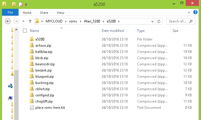

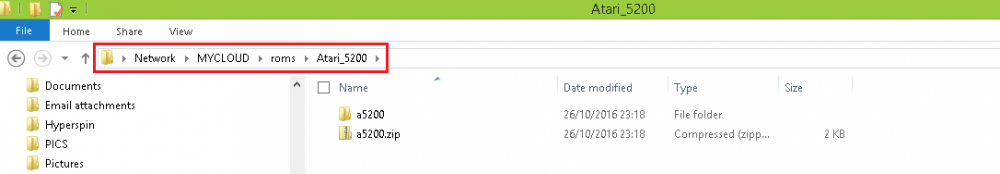

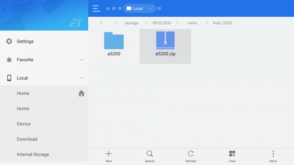

thatman84 Posted February 22, 2017 Author Posted February 22, 2017 Try this also your zipped 5200 bios needs to be in with your zipped roms in a folder called a5200 Official Hyperspin Tutorials Playlist HS Android Overview & Install HS Android Base Pack Download My Tutorials
