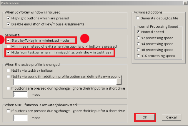

gigapig Posted November 25, 2016 Posted November 25, 2016 If you have Hyperspin 1.4 then it does work with controllers but not very well so it's best to leave it. Like Yeuxkes has said use a keymapper of your choice, I have recently install JoyToKey on my cab and I'm really happy with it. Follow Spawks excellent guide to set it up and I have add it as a start up program in Windows. You will need to set controls in most emulators and then create a blank system or game profile in Rocketlauncher UI. If you don't create the blank profile then your HyperSpin profile may interfere with the controls you set in the emulator. Also remember to check the box below on every profile you create. Oh and you don't need a keymapper for Mame.
