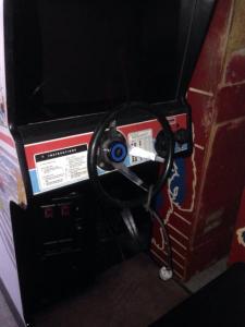

Hey guys
I acquired a Pole Position Cockpit, the wiring is a mess and the pp2 pcb is shot, the monitor is fine, and the cabinet is good... What to do now???
I see 3 options
1. Try spending a bunch of time and money fixing the pp2 and wiring to have an original all working. (It will break again eventually though)
2. Throw a computer with hyperspin in it with an ultimarc vga 5000, and have computer based racing games available to me.
3. Use an original xbox with a huge list of racing games including pole position. (If I go this route, I need some help getting the steering, shift and gas /break pedals converted to xbox controls)
What should I do??? Please someone with experience help me out!!!

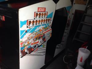

SORPH! whats up bud.. I got a PP cab and am going to use an original xbox with coinops. I got the xbox to jamma adapter (the one with CGA) so I can use the original monitor. I also bought a nice steering wheel/pedal set for the xbox and will be hacking into the cab to make that fully work. Should be pretty easy. Once I get started on it I will let you know my progress and what I do. I have a buddy in Florida helping me with since he has done something similar.
Sweet! That's really cool, can you post a link to the xbox video cable / cga convertor you used?
