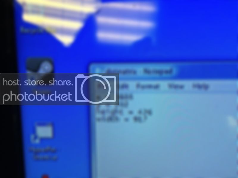

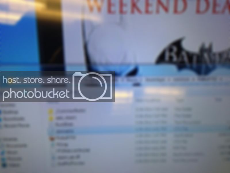

shakenbake Posted March 28, 2014 Posted March 28, 2014 That's right folks. With an update from Steam you can now move your DMD to your third screen. Enjoy!!!!!!!!!! Here's how you do it. Youn numbers may be different than mine depending on your screen resolution and if you're using a 2 or 3 screen cabinet. First in the PFX2 settings menu change the DMD size setting to OFF Then do this
BamBam Posted March 29, 2014 Posted March 29, 2014 Shut the front door! I was hoping for something like this as I have most of their tables. Beauty! So I assume I create a config file with the following or similar entries. Are there spaces between the = symbol and the surrounding characters? x = 3886 y = 202 height = 426 width = 917 or x=3886 y=202 height=426 width=917 I love this stuff man!
boogies2 Posted March 30, 2014 Posted March 30, 2014 Cool - Does it support a real DMD, or is it just working with LCD's?
shakenbake Posted March 30, 2014 Author Posted March 30, 2014 There is a space before and after the = sign
