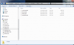

gigapig Posted March 31, 2014 Posted March 31, 2014 Did you create a dats folder in the Mame directory, and copy into it the history.dat and hiscore.dat? You probably already have a "hi" folder also??
rascaluk Posted March 31, 2014 Author Posted March 31, 2014 Did you create a dats folder in the Mame directory, and copy into it the history.dat and hiscore.dat?[ATTACH=CONFIG]39781[/ATTACH] You probably already have a "hi" folder also?? I have them already but they were copied over from the other PC rather than created on this one.... Going to try delete and create tonight see if that makes a difference....
rascaluk Posted March 31, 2014 Author Posted March 31, 2014 Aha Gigapig, thanks for that! Checked my DATS folder and they weren't in there, they were loose in my MAME root (they worked there previously!), copied them into the Dats folder and it works fine. Much appreciated... Have they had to move in their recently? Can't work out why it worked before if not...
gigapig Posted March 31, 2014 Posted March 31, 2014 Have they had to move in their recently? Can't work out why it worked before if not... Nice one. It may have changed around version 0.150

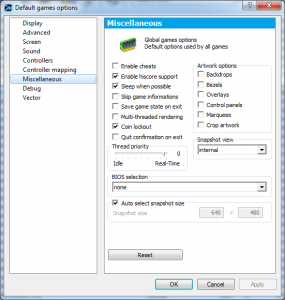

gigapig Posted November 17, 2014 Posted November 17, 2014 Hyperspin should not have any impact on showing your Hi scores in game once Mame is running. There's no setting in HLHQ for Hi score unless it's added to a later module, Which I'm sure your up to date with. Make sure you have the 4 or 5 dats in a dats folder and perhaps make sure this setting is checked. The HiTO text files should also be in the module extensions folder, but I think that's more for HyperPause.
