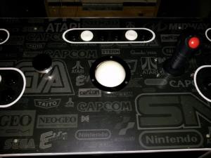

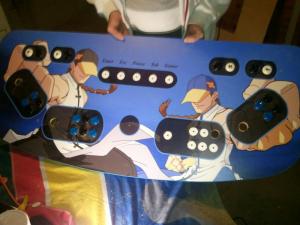

rdhanded2 Posted April 3, 2014 Posted April 3, 2014 I don't like a lot of buttons, but I also wanted anyone to be able to come up to my cabs and play them without having to know shift keys, etc. Otherwise they have to come get me if I am having people over, or they just get discouraged and don't play. This is of course if I am not there with them. I have a row on mine with: Enter Esc Pause Tab Genre Fav One cab I have fav, one i don't. Here are a couple pics. Ignore the dust on them, pics were taken during the build process. My Tekken 3 pedestal conversionBasement Bar / Arcade
