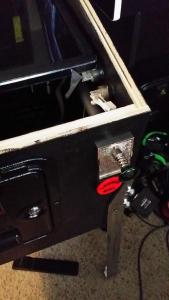

Plunger finally arrived from Virtuapin. Got that installed but need to mess with the tilt sensitivity setting a little. Cranked all the way up the shaker motor sets of the tilt but anything under that not seeing much effect when I nudge the table. Do I need to change something in the table scripts themselves? Can anyone that has one of these let me know what sensitivity setting they are using? Default in VP seems to be 400 with a max of 1000. Analog plunger is working nicely.

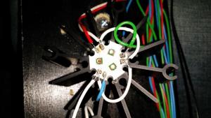

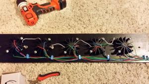

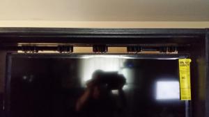

The biggest and most time consuming headache came when I started messing with the LED's which led to a bunch of troubleshooting which Zeb helped out a bunch on. I had LEDWiz outputs not working, power failing on the toys etc. Most of the issues are resolved. A bad ribbon cable was causing some of the output failures. I had some ouputs (flipper contactors) going out intermittently which was resolved by switching to DOF which works a treat. My only remaining issue is power. Once I plug in the lights depending on the table I lose all power to the toys within a couple minutes. Another couple e-mails back and forth with Zeb and he says power supply is overloading and cutting out. I was thinking a 650w would be overkill when I bought it but apparently not. Should have a Thermaltake 850W arriving tomorrow so I'll swap them out and see if this resolves the problem. I also figured out I do NOT like soldering. Happy that is done and out of the way.

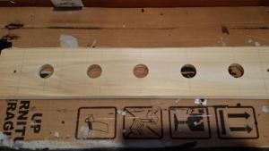

LED's are also installed in the top of the backbox. Having to rethink where I'm going to put the LED strobes as they will not fit on my LED bar once it was trimmed down. Keep going back and forth on underside of cabinet or top of the backbox.
