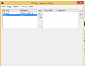

jw21575 Posted April 8, 2014 Posted April 8, 2014 Hey bluc this is my first post but I think I know what you need. You need to go into the ledblinky Control editor and edit your mame defaults. I am not 100% sure how to do this as I use the mame defaults for mame. But this will put you on the right path. Ledblinky is setup to use the mame default button configuration so if you are not using that its why your buttons aren't lighting up correctly. Its the same as if your setting up a new emulator in ledblinky and want to configure what buttons light up and what color. I just am not sure how to change the mame defaults. Im not sure if you have to delete the one that's there and create a new one or if you can edit the one that is there.

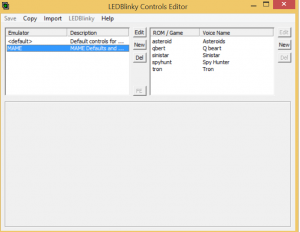

jw21575 Posted April 8, 2014 Posted April 8, 2014 actually here is a better pic of the default for the controls editor. I downloaded led blinky again so I could try to help. since my cab is downstairs.
bluc Posted April 8, 2014 Author Posted April 8, 2014 Ok I thought that may be the case but then I thought perhaps it needs the controller file to read how the buttons are mapped in mame. Have not been able to work out how to use the controls editor going to be slow if I have to manually adjust each game.
