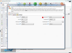

I have a question about using the Mame emulator in Hyperlaunch and hlsl. I installed the 0.153 version of mame (downloaded at mamedev.org). The emulator works with my games (SNK NEO GEO).
Now i am trying to get a better video. I used "edit global module settings" in HyperLaunch HQ under installed modules to make use of hlsl. This works, when running a game and pressing "TAB" i can access the hlsl options.
But hlsl prescale is not present as an option? e. How can i make use of the prescale (for better video quality)?
I did make the Mame.ini (using the commandline: MAME64.exe -cc) inside the emulator folder. Within the mame.ini i added the following code:
hlsl_prescale_x 4
hlsl_prescale_y 4
Is this the correct way to do? I do not notice any difference when looking at a game (metalslug 1). And are the any other settings i can use to improve the video quality?

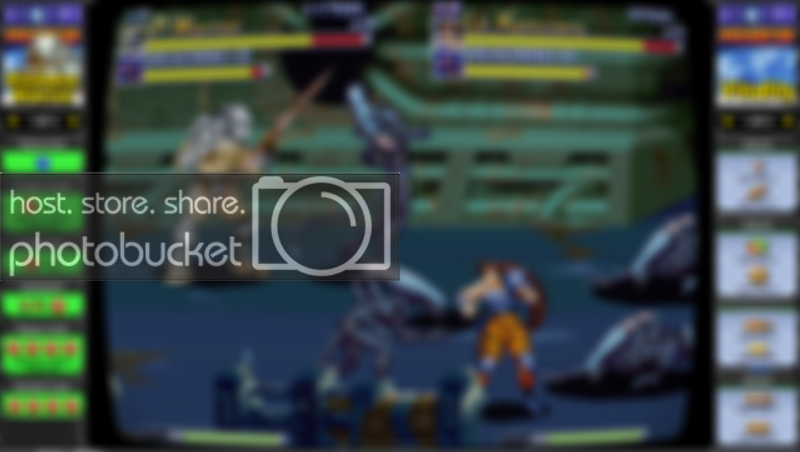

Hi Giga I've used these setting and I was able to get the rounded corners but there seems to be a some sort pre-made glare going on in the right side of the screen. Is there anyway of getting rid of that. I'll see if I can get a snap shot of what I am talking if you need one. Also is there anyway to bump up the colors a bit more? To me it looks a tab bit washed. Also I would like to add bezels to my mame something like this. Is there a tutorial on adding bezel art somewhere?
[sIGPIC][/sIGPIC]
you need to download an updated post.fx file to get rid of the glare or reflection (google jezzeshader). I can't attach files here, so maybe someone else can post it.
I've downloaded this post.fx file from this site Located at the bottom. Giga had the link within his youtube tutorial. Do I need another post.fx file? And the file you are suggesting to post would I be able to do the rounded corners as well?
[sIGPIC][/sIGPIC]
The file you downloaded includes the reflection, vignette and rounded corners. There are a couple of variants to this file, the one I suggested includes the rounded corners but without the reflection.
Any Idea as to where I may obtain this/your file? Thanks
[sIGPIC][/sIGPIC]
Thanks for bringing this up guys, I was looking into removing the light spot as it was very distracting while playing Gradius.
I'm still searching for a better post.fx file, but for the time being I've been able to remove it by editing the post.fx file.
The areas to remove are Light Spot and Light Reflection, both need to be removed or you get a black screen.
I have attached it for convenience.

Thanks for this Giga. I will give it a go but any info as to adding side bezels in mame or hyperlaunch HQ? I need some sort of tutorial.
[sIGPIC][/sIGPIC]
Really? Look to the last link in my signature, or if you just want user created bezels just set it to true and then under "Edit Global Module Settings" set the bezel mode to "Normal".
You'll then need to put the bezels in :Hyperspin\HyperLaunch\Media\Bezels\MAME either in the default folder or if game specific in a folder named after the Rom.
