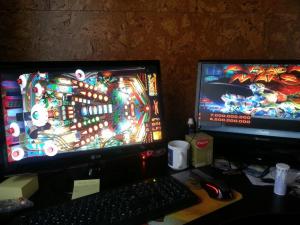

maestro72x Posted May 23, 2013 Posted May 23, 2013 I am trying to get my DMD to stay on my second screen an am having an issue.. I am running Vpinball on my mac book retina and using my dell as my main playfield. turns out even tho i make my dell as my main monitor the dmd wont stay on my laptop. if i make the laptop the main screen the dmd WILL stay on the dell.. any ideas how to make the dmd stay while using the laptop as the DMD/backglass screen?
kaboz Posted December 19, 2013 Posted December 19, 2013 hi i have exactly the same problem than spacegoogie , and it's impossible to solve i just tried EVERYTHING , any idea ? here is my bug : it always start like this, after a certain value of X or Y it doesn't save thuis value when i restart the table
