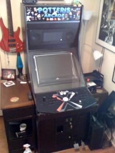

intrglctcrevfnk Posted May 28, 2010 Author Posted May 28, 2010 Looks like I might have buyers remorse..... I just sat down at my cabinet and I cant find anywhere to mount it so I can reach it. OOPS! The only place to properly mount it is below the CP, which is shelved out from the main body. So I'd have to reach underneath (where I cant see) which would also require bending down. Damn, should have thought of that earlier.... Save it for project #2? Anyone see a place to put it?
Secret80'sMan Posted May 28, 2010 Posted May 28, 2010 How about building a box that attaches to the right hand side of the cabinet. Will be ugly but should serve the purpose.
intrglctcrevfnk Posted May 29, 2010 Author Posted May 29, 2010 How about building a box that attaches to the right hand side of the cabinet. Will be ugly but should serve the purpose. good idea. might be able to make it modular with some quick disconnects.. thanks!
