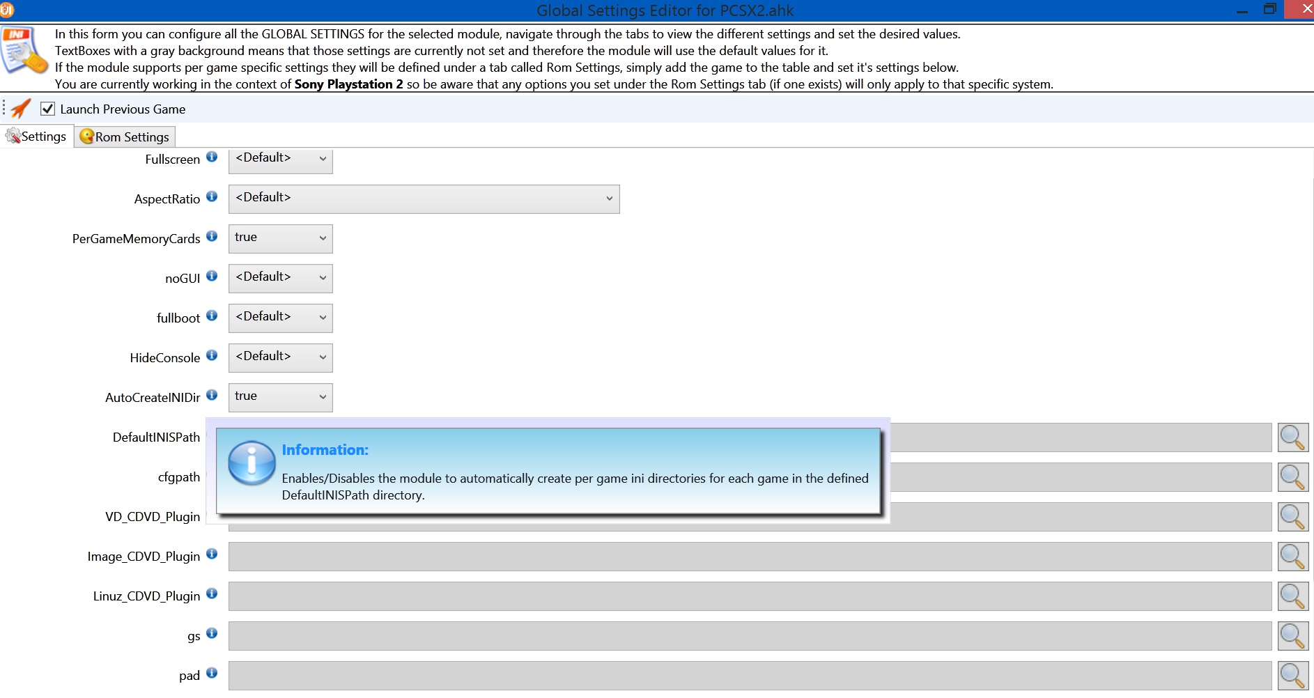

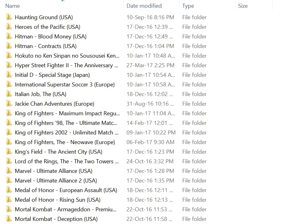

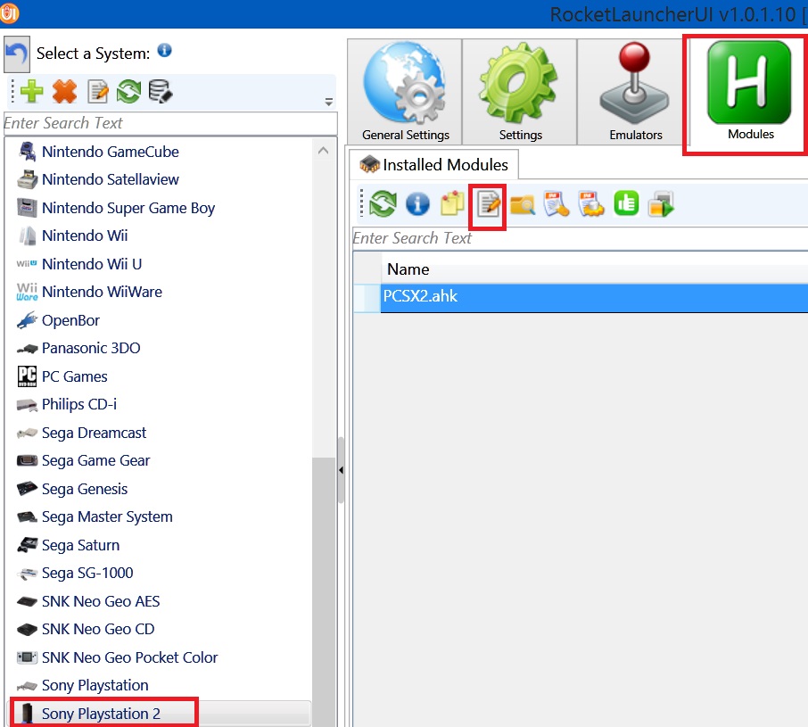

I have the PCSX2 module to use per game configs, check in the PCSX2 module settings and make sure you have everything setup this way.
Check the module settings:
Make sure you have Auto Create INI dir, this option will create per game configs, so you can have all games working, with specific hacks, resolutions, aspect ratios, if some are wide-screen or not, etc., etc., this setting is the most important in my opinion, some PS2 games will work only in a full boot, or with specific hacks that could break other games that work without any hacks, etc.

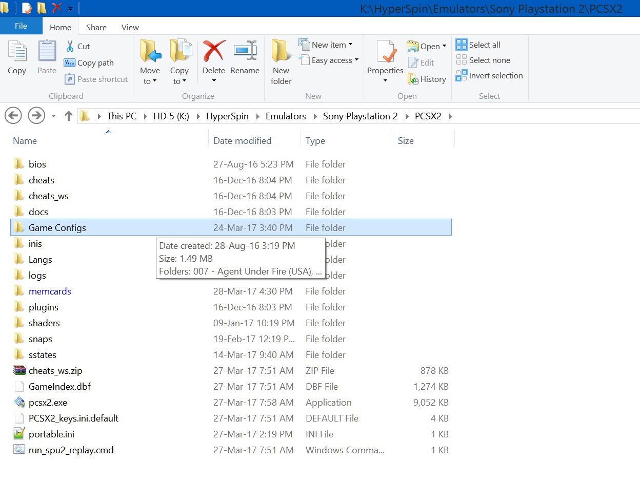

It's also important to check if you have this folder Game Configs in your PCSX2 directory, if it doesn't exist, create one, or specify yours using the "cfgpath" shown in the above picture:
With everything setup, try running some games, specify your settings for a specific game or two and open the Game Configs folder, if you see folders like in the picture below, auto generated, it's all set.
Tip: Before you activate per game configs, in case you also find this option useful, make sure you have a main "default" configuration for all games, for example, full screen, resolution, aspect, speed hacks profile or anything that could be useful for most games, so when you need to change specific game configs, you won't need to set the other stuff that are OK already.
PS: Some games, like Need for Speed Carbon need a very specific configuration to work and some games can't boot in MTVU, and that's when you'll want specific game configs to do the work for you.
