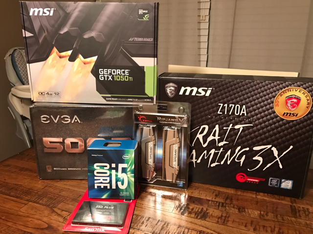

mafiafan123 Posted May 28, 2017 Posted May 28, 2017 This setup did way more than I needed pretty much no slow downs also runs MKX on Ultra Sent from my iPhone using Tapatalk
