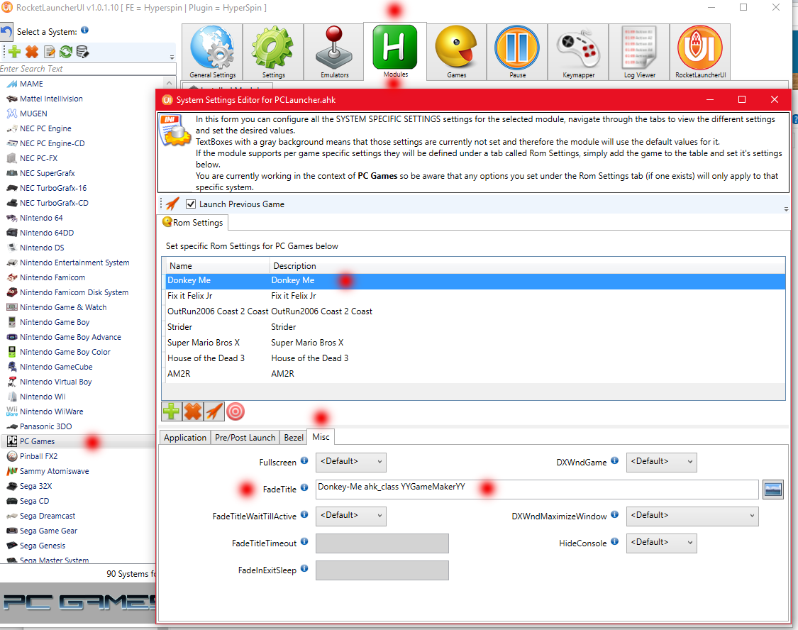

gigapig Posted August 15, 2017 Posted August 15, 2017 The settings are under "Edit System Specific Settings" for PCLauncher. Once in there you choose or add your game (and hopefully you've already been doing this to add PC Games) and then add the Appwait or Fadetitle. Fadetitle can be found as the picture below, it requires a little more work as you need to use the "Window Grabber". Please check the tooltips and module notes. Appwait is easier as you just need to run the game, then Press CTLR-ALT-Delete and the find the name of the process that is running for your game (Example: TMNT.exe) you would then add that to the Appwait box.
