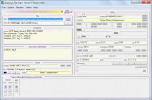

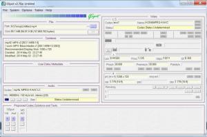

pavlovtiger Posted May 3, 2014 Author Posted May 3, 2014 Right, so. Here's the thing: the mp4 videos that work on the Hyperspin wheel are encoded as H.264 MPEG-4 AVC. GSpot reported this for the dozen or so videos I pointed it to from my SNES media folder, and when I went and did a test recording and encoding of my own video, this time telling Sony Vegas to just make me an mp4 of this exact sort, lo and behold my mp4s work in Hyperspin again. They also work for editing in Sony Vegas, a function which I previously lost for whatever reason. Following is the two GSpot screen shots I took, the first showing the Super Ghouls 'N Ghosts mp4 from Hyperbase, the second showing the untitled mp4 I made recording footage from my emulator of the same game, and rendered in Sony Vegas. Ignore the obnoxious file size, it was just for educational purposes. >.> So, apparently either the K-Lite codec update sorted me out with H.264 MPEG-4 AVC or something else has happened, and hopefully you can make this work for you somehow as well, all I've done is update K-Lite and install an external FDDShow, which I'm not even sure I needed or not. And the aforementioned VC Redist runtime, but we've established that's immaterial.
