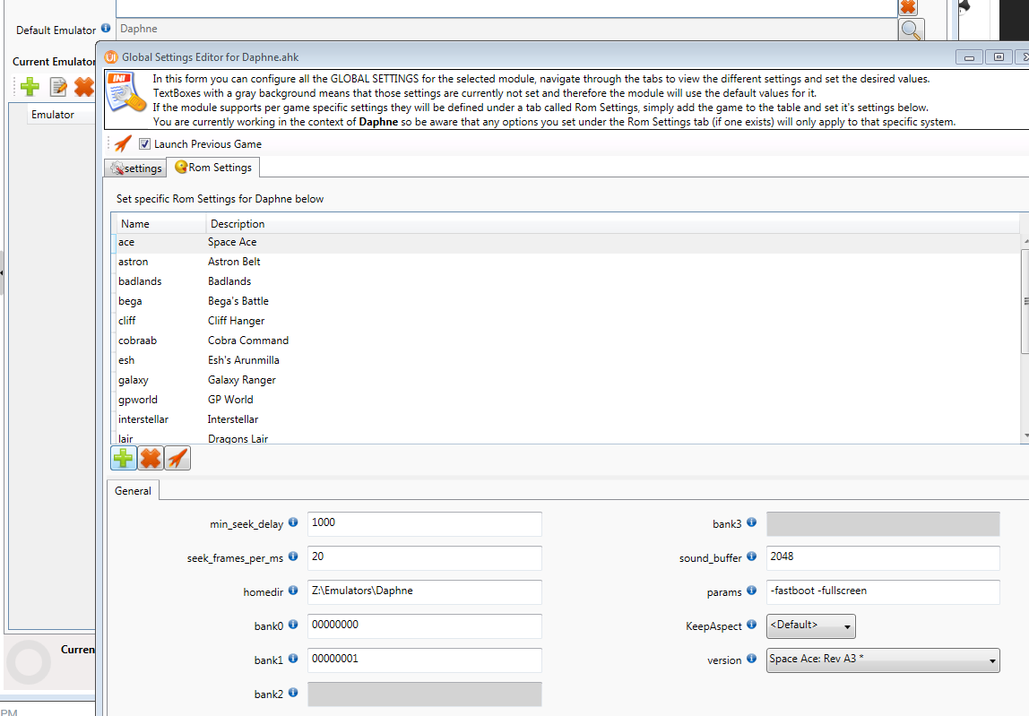

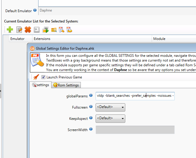

Spawk Posted December 18, 2017 Posted December 18, 2017 Ummm... So you are not using RocketLauncher??? It's never a good idea to use .bat files. If you only need 1 parameter for all games it can go here under "globalParams": Or else you can specify parameters for each game here in next tab over under "Params":

mamemaniac Posted December 30, 2017 Author Posted December 30, 2017 Thanks Spawk!!! I was able to get the scoreboard working with installing new Daphne files and RocketLauncher. Without your screenshots I wouldn’t have figured it out. Now to get the annunciator for Space Ace working....
