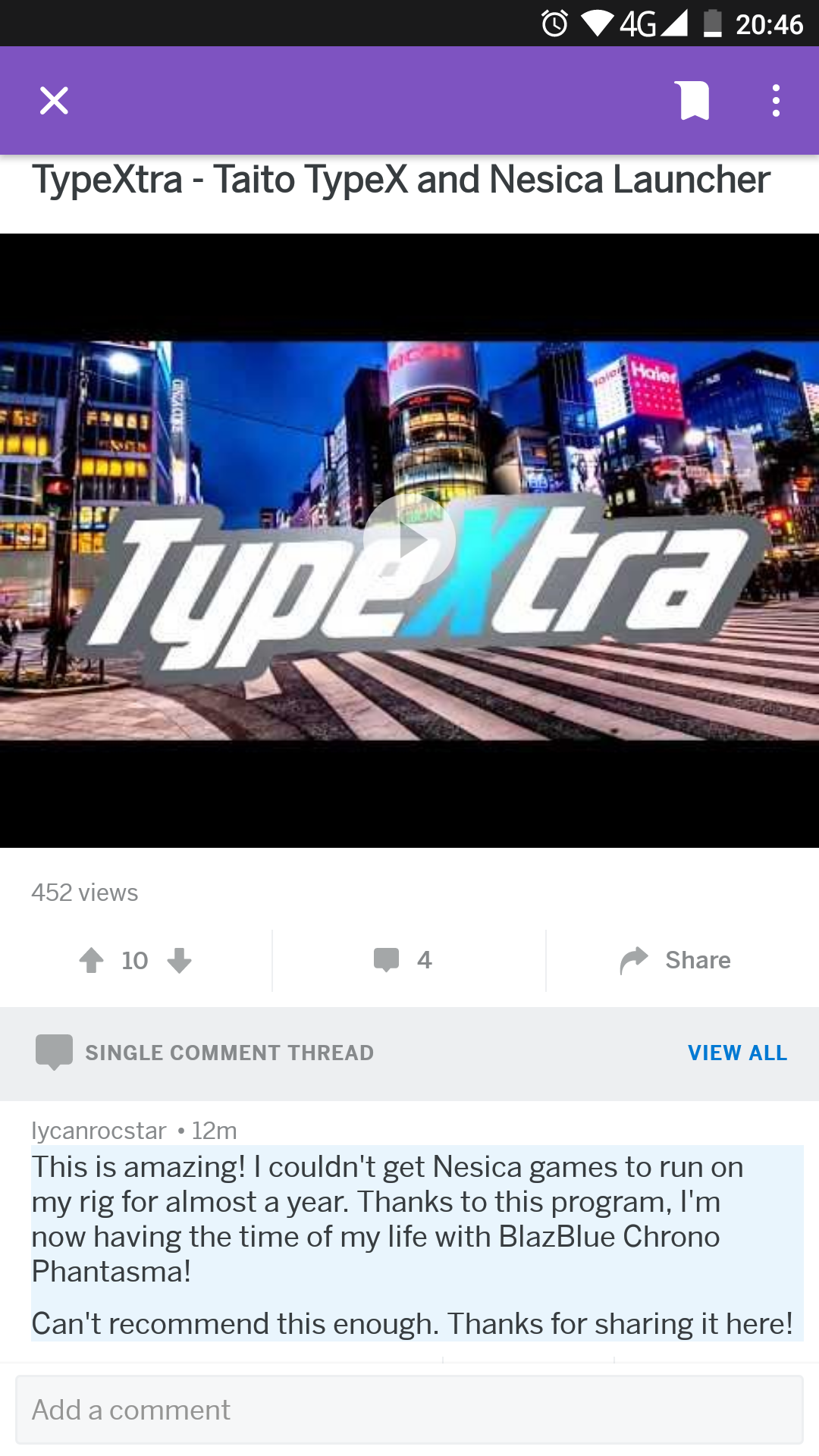

stigzler Posted January 21, 2018 Author Posted January 21, 2018 3 hours ago, RLBradders26 said: @stigzler seems to be going down well. Heh. I would be chuffed if I could make head or tail of that screen shot. Is that twitter? <doesn't do social media!
