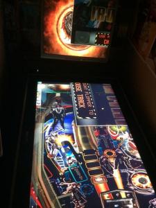

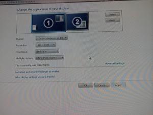

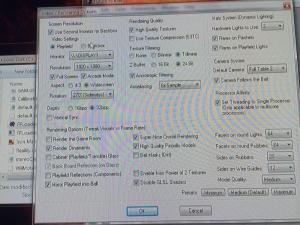

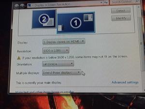

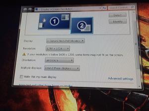

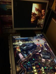

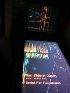

monkeychunkuk Posted August 3, 2014 Author Posted August 3, 2014 Grrr ok So I copied as above And matched my setup But still got this No joy but if I run both play field and back glass on non full screen mode I can drag the back box to the screen and centre it But won't work when I get go back putting the back glass on display 2 it over gangs both and I can't grab the window to drag it in place ; ( I'm sooo close yet so far Just a question in the monitors settings on your PC do you duplicate desktops or extend? I have it extended when I click other option It won't show up on the option to use second monitor as back glass
mikekim Posted August 4, 2014 Posted August 4, 2014 Extend desktop Sent from my GT-N7100 using Tapatalk
monkeychunkuk Posted August 4, 2014 Author Posted August 4, 2014 Yup Extend desktopSent from my GT-N7100 using Tapatalk Thanks mike at least I'm on the same page as everyone I wonder if my Gf card software us playing around with it ?

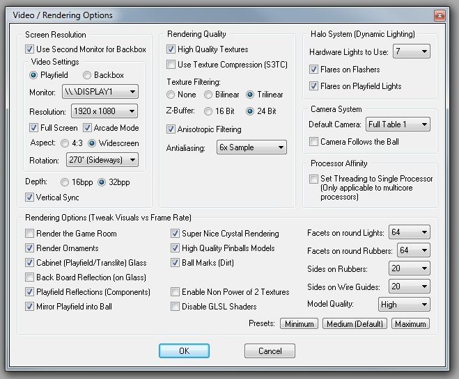

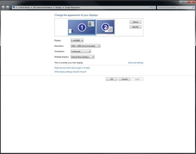

mikekim Posted August 4, 2014 Posted August 4, 2014 my settings 1 is main screen (play field ) 2 is backbox. note that they are level at the top and that screen 2 is to the right of screen 1 if i select //display 1 or 2 on this screen the details are the same so i only took a pic of //display1 hope these help.. btw i don't use bam for Future pinball.. i just setup the tables manually infact i don't use future pinball much anymore, stick mainly to VP these days.. (far better physics)

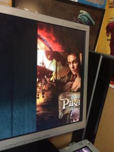

monkeychunkuk Posted August 4, 2014 Author Posted August 4, 2014 Hey Mike thanks for putting up with my constant posts Yup I've stop using bam way to many options to bugger up settings I tried matching your screen position funny enough that's what I've been do all night trying to figure if that's doing it As I manage to move the back box down and inch?? But I still get the same notice how even the Scroll lock settings are off screen ? And erm visual pinball looks even harder to setup ; (
monkeychunkuk Posted August 4, 2014 Author Posted August 4, 2014 This what I can't understand how comes hyper Pin looks fine !
RenegadeFred Posted August 5, 2014 Posted August 5, 2014 I'm completely stumped on this one. Did you try reinstalling your video card drivers?.. or possibly starting a fresh install of the OS and going from there? It's like the main screen is way off the 0,0 point when loading FP. VP is easy to figure out once you have a few tables under your belt.

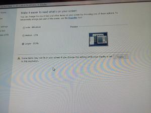

mikekim Posted August 5, 2014 Posted August 5, 2014 Do you have the display dpi set to 100%. I've seen issues where people have it set to 125%
monkeychunkuk Posted August 5, 2014 Author Posted August 5, 2014 Do you have the display dpi set to 100%.I've seen issues where people have it set to 125% Ohhh that's good where do I check that ?
mikekim Posted August 5, 2014 Posted August 5, 2014 Control panel - appearance and personalization - display. Set custom text size (dpi)
monkeychunkuk Posted August 5, 2014 Author Posted August 5, 2014 Control panel - appearance and personalization - display.Set custom text size (dpi) I've said it once I'll say it again you RULE!! That's what it was I owe you so any beers !!!

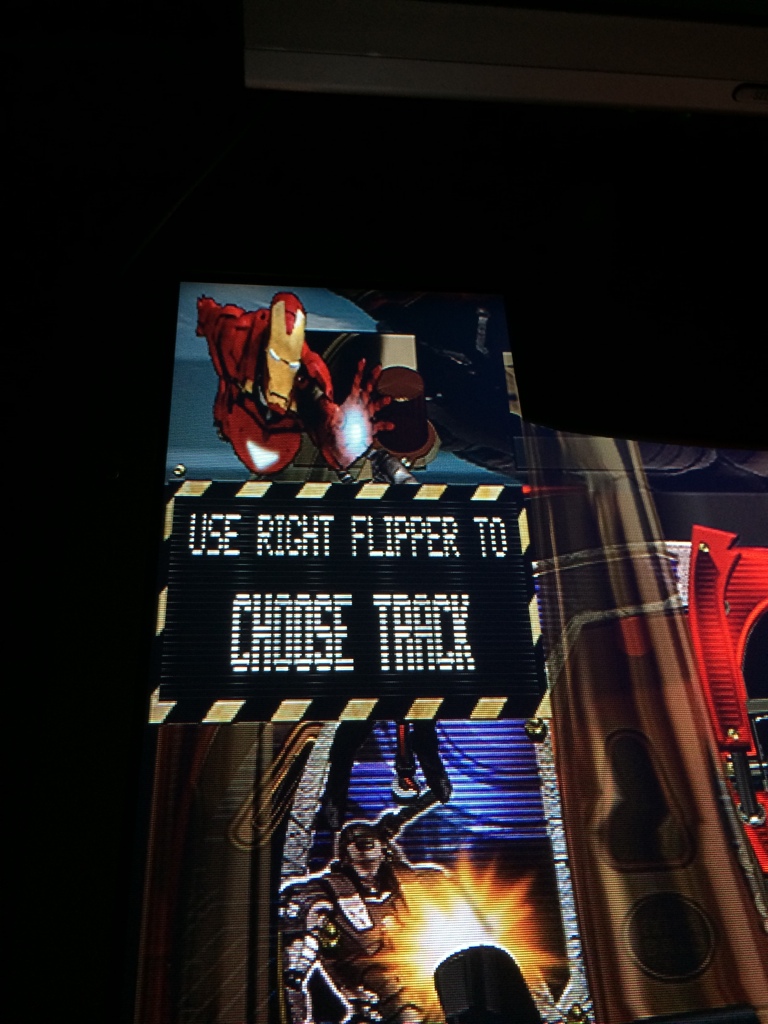

monkeychunkuk Posted August 10, 2014 Author Posted August 10, 2014 Found a faster loading updated version f the iron man table Anyone know how to get rid of this this screen?
mikekim Posted August 10, 2014 Posted August 10, 2014 I thought it was a part of the table.. as you use it to select what music track you want to listen to when playing Sent from my HTC One_M8
monkeychunkuk Posted August 11, 2014 Author Posted August 11, 2014 I thought it was a part of the table.. as you use it to select what music track you want to listen to when playingSent from my HTC One_M8 No it's a just mimics the the back glass
mikekim Posted August 12, 2014 Posted August 12, 2014 Select it in the table editor and drag it off of the playfield
